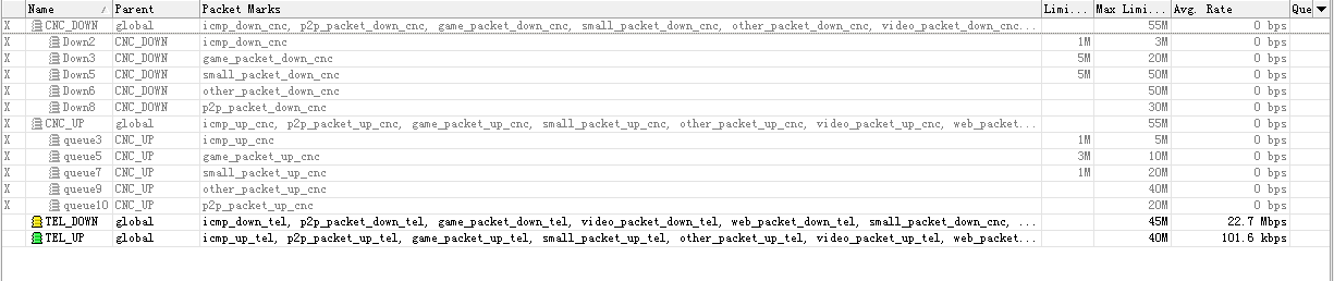

I am using HTB+PCQ queue tree,it works fine in 3.xx~5,xx but not works at Version 6.xx.
1.as title, everytime i changed things in queue tree,queue tree don't response any more.
2.as attached file,Down2 Down3...Down8 can not work at same time.(queue tree don't work with parcket markets )
today i tried update my RB951-2n from version 5.25 to 6.1,found same bug. the queue tree is work fine with version 4.xx~5.xx,but not work with version 6.xx.
as u can see in the jpg file,i disabled the queue tree because it doesn't work .

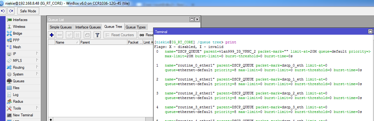

Hi.
On 6.0, Winbox does not show queue trees after making a change, but the Terminal does. This was not an issue in the 6.0 RC11 version the CCR shipped with as far as i know.. Any advice on this?
Same here.
I restarted and it showed back.
But now can’t even stay with skype, keep disconnecting.
version 6.0 CCR-1016-12G
any suggestion??
help plz!
I bought the CCR-1036-12g-4s, it was shipped with 6RC11 and has some issues and i upgraded to 6.0 .
Queue are not working at alla and it was showing some times and sometimes not, please fix and release the next version

2 WAN named:WAN_CNC and WAN_TEL
1 LAN named:ether6_LAN
in mangle, i marked conn for P2P,Games etc… then marked packets upload/download like game_down_cnc,game_up_cnc,small_down_tel.. etc
u can see the Bytes/Packets counters are working fine and numbers is changing in mangle, but in queue tree with packet mark, they don’t work at same time (packet counter read 0),only 1 of quere trees has packets reading at same time in winbox .
i attached mangle and queue tree,plz hlp me . those setting is working good in version 3.xx~5.xx
tree.rsc (2.6 KB)
mangle.rsc (10.5 KB)

this is what i mean “can not work at same time”,in my case, only one bewteen(Down1~down8) have packets if u changed their priority or Limit at or something.
