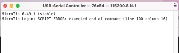

For any future Google searches. I am also seeing this issue on the RB4011iGS+5HacQ2HnD, but I’m NOT running (and NEVER have) a beta firmware. Running 6.49.1
There is a bad bug with the default-configuration of RB4011iGS+5HacQ2HnD and 6.49.1.
Steps to reproduce:
  • Get a RB4011iGS+5HacQ2HnD
  • Flash with 6.49.1
  • Perform a system reset:
  • /system reset-configuration
  • y
    Wait for reboot, and you’ll receive this console/error message[/list]
    The lines in question that is failing is:
    Line 99: set $ifcId channel-width=20/40/80mhz-XXXX;
    Line 100: set $ifcId secondary-channel=auto
    Line 101: set $ifcId frequency=auto
