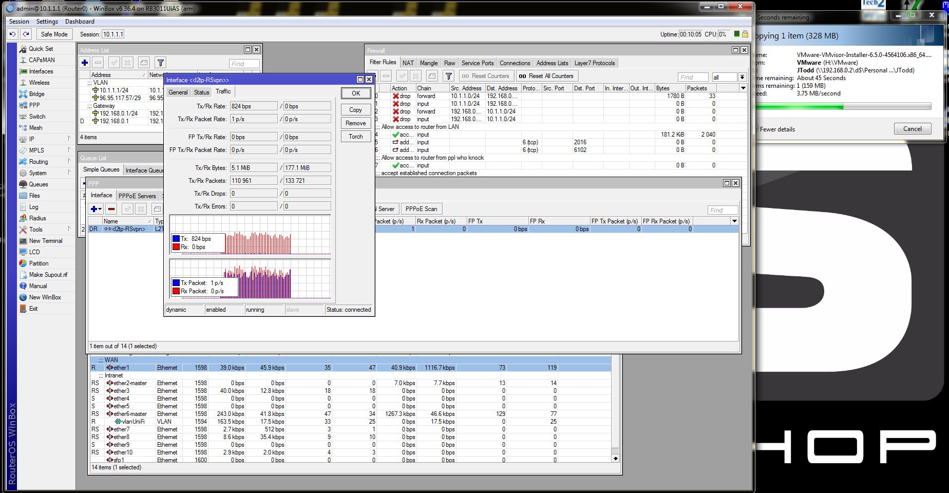

I checked that and i noticed that L2TP connection was disconnected after 176-178MB downloaded. It happened on 5 VPN servers (x86) in different locations, after made upgrade.

Hi, I had the same problem with current releases. I was unable to transfer some large file over L2TP, it stopped working at around 175-180 MB. I have tried to downgrade to 6.36.3 and now it works fine and stable…

I investigated this problem. It appears after Windows client decide to change phase2 SA.
Client==>Mikrotik SA, comes up normal.
Mikrotik==>Client SA, don`t comes up.
After this L2TP stop sending/receiving hello packets and broke up.
FYI Windows 10: Lifetime 60min; Lifebytes 100000KB
This issue is fixed in 6.38rc. There was an issue with new SA establishment when life-bytes value is reached.
