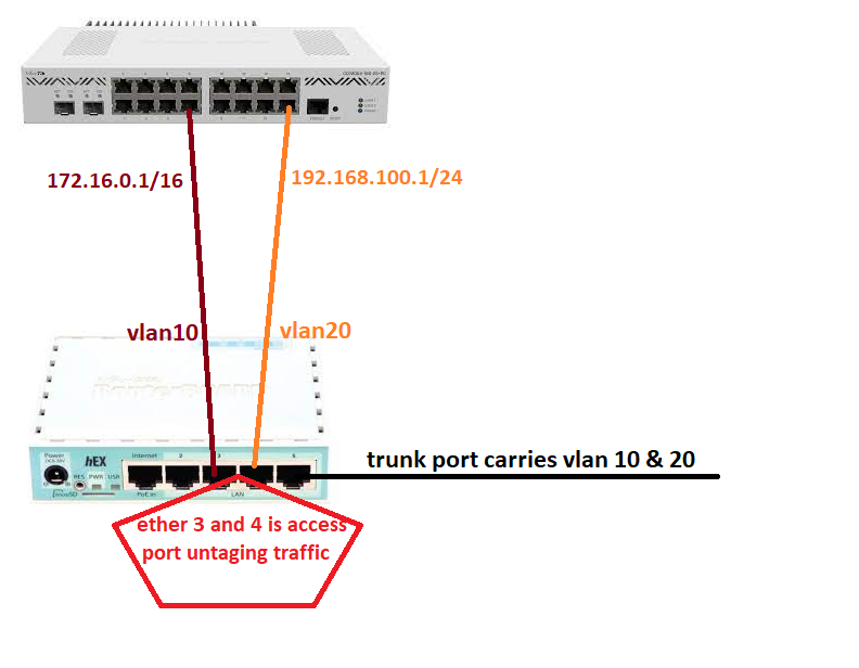

I have 2 Mikrotik routers.
Router-1 is directly connected with router-2 on port-4 which is the VLAN Access port.
I’m not able to access my Mikrotik Router-2 via RoMON. on Router-1
I have OS V.7.11.2 on both router

i can’t able to access Hex 750gr3 via RoMON from Mikrotik CCR2004 which is my main router.
The drawing is already helpful but we really could use config please.

PS why 2 separate links ? One for each switch chip of CCR ?
Dear sir,
Ignore please its topology of my network.
