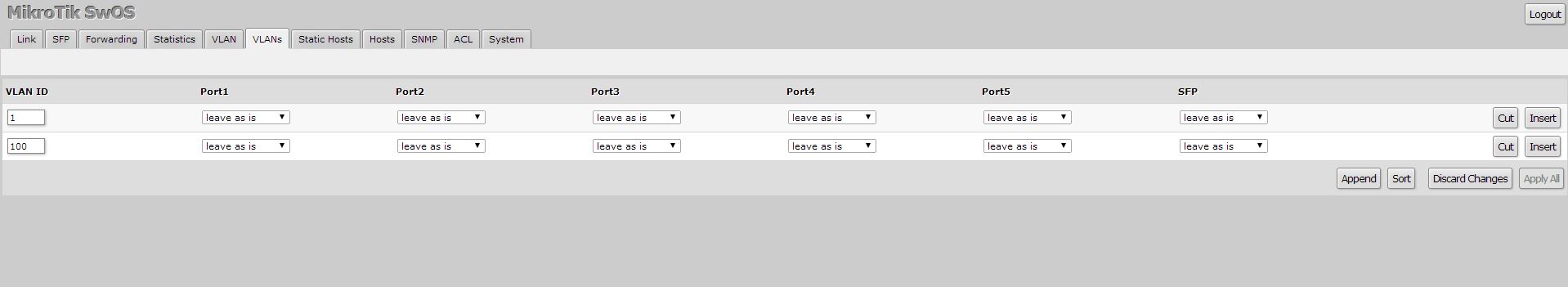

It seems that the switch thinks it is RB260 as the interface changed and I can also see SFP tab in the menu.

Once the switch booted up, I could see the the VLANs interface has changed to what I suppose looks like RB260 rather then RB250.
Which would not be a problem but it cannot save any VLAN settings now. I can add VLANS but the port settings don’t save.
Also reboot button from the menu doesn’t work anymore.
Please see attached VLANs.jpg to see how the interface of my RB250 looks now. Before it was just with checkboxes for individual ports instead of dropdown boxes. SFP tab appeared now as well.
