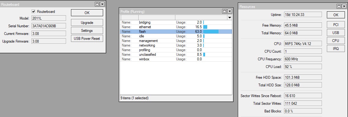

CPU hits 80-90% because of flash (Profile reports) every ~3sec or so…
ros 6.4 with 3.09 firmware

i seen similar issues with my grooves. which running ROS 5.x. luckily didn’t happen for a long time. how about your memory usage at that moment? i have the feeling that when it happen also mem usage goes up.
what configuration you have on that RB951? I see that that CPU usage is very high, what process you are using? I see that you have overclocked the CPU to 700mhz, does your problem happen if you lower the CPU back to 600mhz?
Also RB2011 with 6.4 no occ. Ruter is in bridge mode all ports an process Flash takes ~50-60% all the time.
Ruter mode. Doesnt matter if I lower the cpu speed. With 6.1 is working good.
