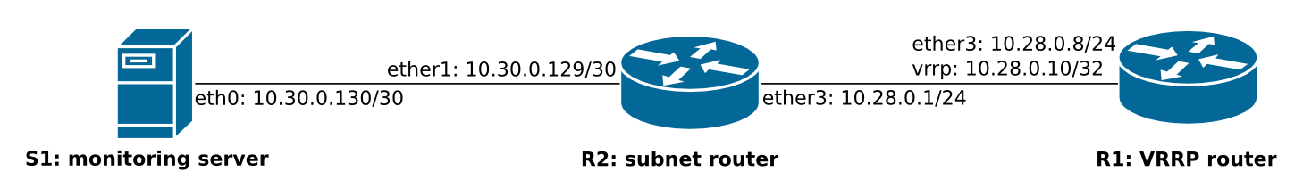

Hi! I would like to report a strange bug. SNMP based monitoring of Mikrotik router stopped working just after deploying new configuration, involving VRRP. The router R1 is not responding to SNMP queries on IP address assigned to VRRP interface, if queries are sent from the monitoring server S1. Here is an example linux command which I am using for verification:
root@S1:~$ snmpwalk -v1 -c public 10.28.0.> 10
Timeout: No Response from 10.28.0.10
But everything works just fine if queries are sent to the IP address assigned to physical interface. Example command:
root@S1:~$ snmpwalk -v1 -c public 10.28.0.> 8
iso.3.6.1.2.1.1.1.0 = STRING: “RouterOS CCR1036-8G-2S+”
iso.3.6.1.2.1.1.2.0 = OID: iso.3.6.1.4.1.14988.1
iso.3.6.1.2.1.1.3.0 = Timeticks: (7105900) 19:44:19.00
The problem became visible on SNMP traffic, but other UDP traffic is not working as well (ie. DNS). TCP traffic ie. SSH is working without any problem.
I have tested this against RouterOS 6.37rc11
as well as 6.34.6 (Bugfix only) and 6.36 (Current). The behavior is the same all the time.
The strange part of this problem is, that if I provide a direct connection between S1 and R1 by replacing R2 with cable together with moving R2’s IP address 10.28.0.1 to S1, then it works even with IP assigned to VRRP interface (10.28.0.10).

Monitoring server networking configuration:
ip address add 10.30.0.130/30 dev  eth0
ip route add default via 10.30.0.129
