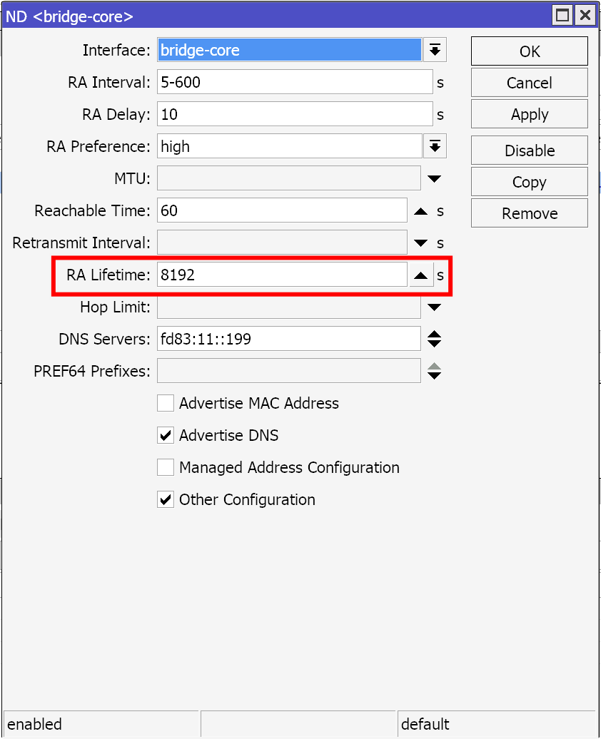

I also struggled with this for a while, but tonight I finally discovered the issue: the RA Lifetime must be set to a value greater than 0; otherwise, the gateway (aka router) will immediately disappear. This might not technically be a bug, but RouterOS should ideally have a minimum default value.
But the default value is 30 minutes. If you create a new ND entry in Winbox, the 1800s value is prefilled. Also, both this default value and the meaning of RA Lifetime = 0 are documented:
ra-lifetime (none | time; Default: 30m) Sets the RA lifetime. A Lifetime of 0 indicates that the router is not a default router. (see Section 6.2.3 of RFC 4861)

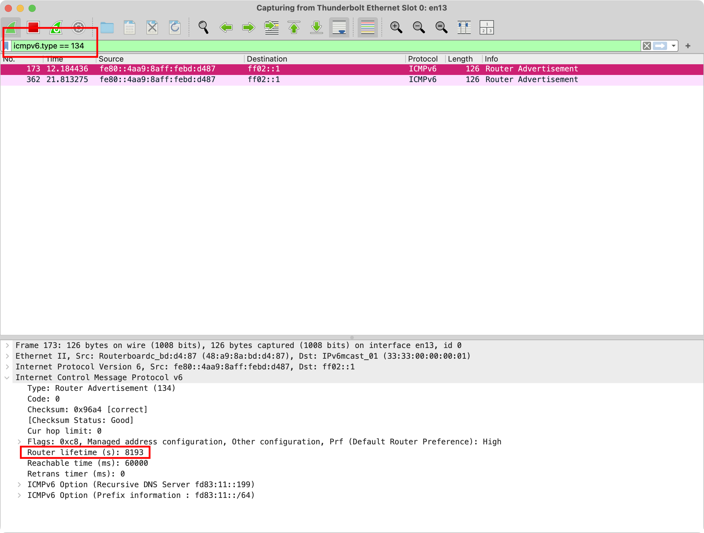

You can use Wireshark to capture packets, with the filter set to icmpv6.type == 134. In the latest version 7.17rc3, the current results are as expected.
