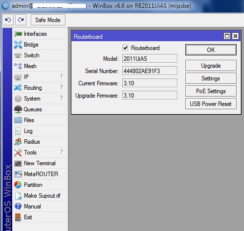

I also don’t have a “PoE Settings” button in System>Routerboard

Looks like the LCD menu is not showing for models with “i” in the name. Fix is coming for v6.8
