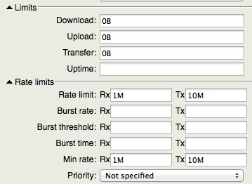

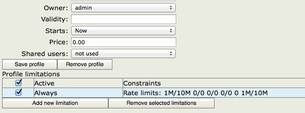

This is the profile in um:
This is the limitation:
And this is what they got in simple queues in the APs:
