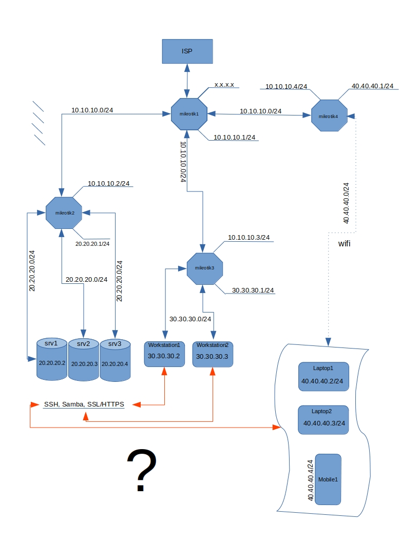

Hello guys, i am using RB951G-2HnD to my satisfaction but as time goes things has changed and i need to “rewire” my lan.
I have bought 3 additional RB760iGS’s in order to achieve something like this:
This is basic diagram and in the first step what i would like to know is how to make services hosted on srv1-3 available to networks 30 and 40.
What would be the correct and safe way to do this?
In the next steps i would need to define the DMZ and multiple VM’s and containers will be siting in their respective VLAN’s but that is quest for another day.
Could someone please kickstart me here and provide me with some hints and points how to start building this?
Thank you
There are different approaches - you could route between subnets on mikrotik2-4 and have static routing rules on mikrotik1 so traffic is directed to the correct mikrotik, or you could use mikrotik2-4 as switches with VLANs and perform all of the routing/firewalling on mikrotik1 which is probably the more common method. http://forum.mikrotik.com/t/using-routeros-to-vlan-your-network/126489/1 is a good starting point.
RB760iGS won’t be good as switches in vlan setup - they lack hardware vlan support, so there will be no benefit in performance compared to routed network.
I would use the router with the most oomph in terms of CPU ram/etc… the one interfacing with the ISP and the rest acting as switches or ap/switches via VLAN routing.
For example I would have bought a hap AC2 perhaps as the main router or even an RB450Gx4 (no wifi). If you know the rest will be switches then acquiring tailored managed switches of any vendor will do fine and return the hexes. In general, I find it less than amusing when someone says this is what I would like to accomplish and here is what I bought to do it with, what should I do>
The right course of action is…hey I am thinking of designing the following network, this is what I have, what should I procure to complete the design and how should I configure it…
Much less expensive and more likely to meet expectations.]
Be that as it may I am currently using my hexes as switches and happy as a pig in shit. I also have 2 mT 260GS switches, three non-MT managed switches, 2 capacs,and 1 non MT AP in my home network.
Performance-wise you’re right. Configuration-wise, VLANs and centralized routing config is much simpler than distributed routing. Plus it would make a good basis for expansion (much easier to add another subnet or increase number of ports within subnet or replacement of RB760iGS with a proper managed switch). Also routing-only subnet (10.10.20.0/24) wouldn’t be needed.
Sure. But then it makes perfect sense to sell/return 2 of the 3 hEXes and buy 3 managed switches instead (or even one managed and two unmanaged will do), and use the remaining hEX for routing only.
Sure. I’d go for managed switches, that way topology can be changed from star-like (as OP currently plans it) to anything else (can be linear, can be star but with different/multiple VLANs present at same hubs and/or spokes, combination of both, sky is the limit). If those switches-to-be will be physically co-located, then it can be single switch with larger number of ports (16, 24, …).
Yes, that’s exactly my point.
Wrong, the point is.

That’s quite a complex network for a home. If it’s being done as a learning exercise then I’d suggest adding something else into the mix, variable length subnets. Typically in a corporate network we’d use /30 or /31 for any point to point links that will only ever have two devices. I’m not sure if Mikrotik supports /31 but I thought I’d mention it.
I assume you are aware that 20.0.0.0/8, 30.0.0.0/8 and 40.0.0.0/8 are not private addresses, there are real users out there on the Internet with those addresses. Using them internally would mean you can’t reach those real users if the need ever arose. It may be far fetched but we did have a customer who found he couldn’t reach certain site, the reason was that his internal use of something like 128.1.0.0/16 stopped him accessing particular name servers.
Tony S
It doesn’t. You need to use pair of /32 addresses with network specified as the “opposite” one.
And it works like a charm. The best thing about using /32 addressing: if a router has multiple such links, it doesn’t have to have different local IP addresses, same IP address can be reused multiple times (with different network part). An example using IPIP links, but should work for straight ethernet as well:

Yes it does! And another great thing about that - the addresses doesn’t have to be adjacent, so I have all my PTP links like 172.27.XXX.YYY - 172.27.YYY.XXX (where XXX is some unique identifier for this particular router). That is perfect for 1) ease of reading 2) the ability to refer to all “other ends” at once as 172.27.XXX.0/24 (for example in ospf/networks).

But you’re right … @digger, please describe the network layout you’d like to have and we may be able to give you some good advice. Surely what you sketched can fly with some static routes on each of involved routers, but as you can see, many of us think the setup you sketched is probably sub-optimal.
