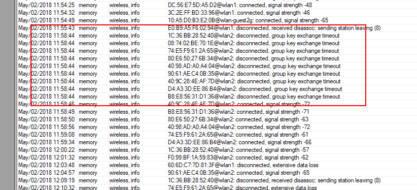

I have a cAP ac unit running 6.43rc5.
I see this message in the log at random times of day when units are connected to the ap but about three times a day…one in the morning one around lunch time and one in the afternoon i get
a bulk Disconnected, group key exchange timeout all at the same time 11:58:44 (see attachment). My users are mostly Mac books and they say they get disconnected for a min or less and they are fine for a while.
I’ve changed channels and same thing at those approx times a bulk of them get kicked off.
Any ideas? Thank you
