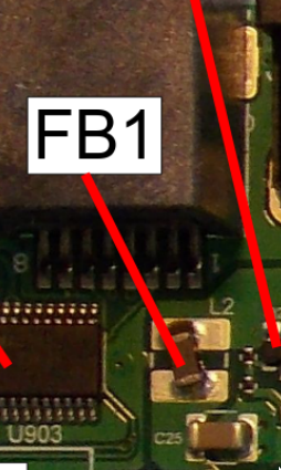

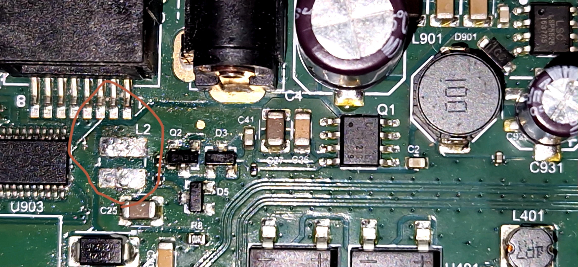

due of a lightning my RB2011 won’t turn on. Connecting a power supply it goes in protected mode. Opened the case I found a burned component, the one marked as “L2” but I wasn’t able to identify it… removed it, obviously the power supply is working but the RB is off. Does anybody have an idea about this? is it a diode, a zener a Varicap? Really no idea…
I attach a pic of the board where the L2 was placed, is marked in red.
Thanks in advance, Leonardo
That seems to be inductor, what number is on it ? Its probably a part of a power supply so no wonder it wont work.

sadly there’s no number on it, ot it’s no longer readable, so I cannot identify it
FB1 CB04YTYH800 Viking Tech Corporation Ferrite Bead 80 Ohm 3A 1204
YES! I got the info from a very kind support system.. now I have to find it :smiley:
thanks all for support :slight_smile:
Ok I found the component on Aliexpress for less than 2,50 euro… 100 pieces… It will take its time to arrive, as soon as I’ll get it I’ll do my test :slight_smile:

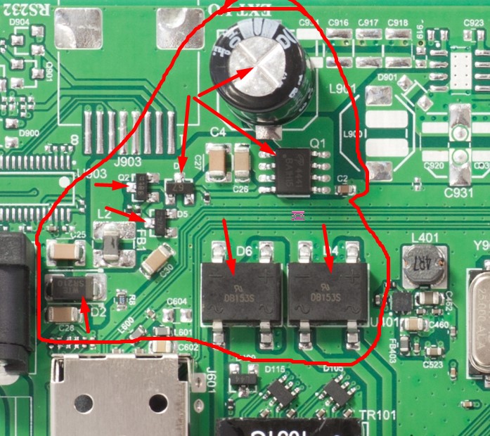

Passive components don’t burn out alone, unless we are talking fuses. Expect some silicone nearby to be fried as well.
You can short-circuit the inductance to do a test. The Schottky diode must be broken and something else in the red circled area. In general, do not wait for inductance, look for other burned parts. Burnt inductance is a consequence, not a cause.
Why didn’t you show the other parts, because the filter inductance was not the only cause?
