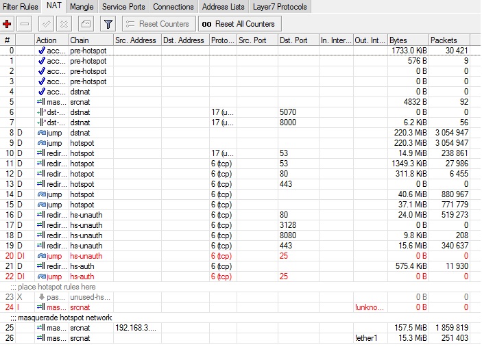

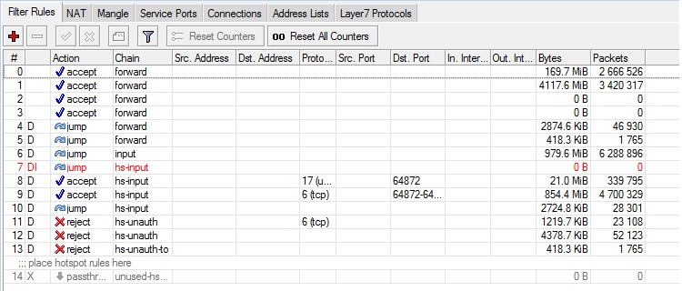

I asked a while back about a way to allow specific ip address from being authenticated by the hotspot using the firewall rules and i was successful in that using filter rules and nat but now i am facing a different scenario which is that if i used ip bindings to block that Ip, i get no access
so now my question is , is there a way to completely bypass that ip address from being processed by the hotspot rules, so no matter what, it still gets through from the router .
The network rules that are in place are in the attachment files

I know i could do it with the ip-binding bypass but my question is, is there a way to avoid processing packets from this ip address by the hotspot ?
