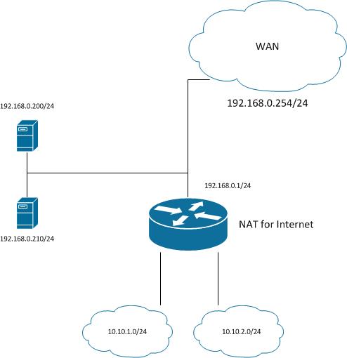

My story is that our ISP isn’t giving us a public ip as normal ISP would do, but instead they are giving us /24 private ip network with the nat on their side with public ip. So - right now our GW is 192.168.0.254/24
As i wanted to create other internal networks i installed RB450G and created my desired networks behind Mikrotik NAT(10.10.1.0/24 and 10.10.2.0/24) (my ISP is not willing to create static routes to my new internal networks).

Not all the time, but sometimes they get the same errors and i think these errors are, because all the packets coming from the new networks are being NATed. but the server is not expecting packet from 192.168.0.1
Here is the graph to understand better:
WHAT I WANT TO ACHIEVE:
For the connections from 10.10.1.0/24 and 10.10.2.0/24 to hosts on 192.168.0./24 I want to bypass NAT that’s is thought only for accessing the internet.

The 192.168.0.X/24 network is at your WAN side and as your ISP is unwilling to add any static routes to its router 192.168.0.254 then you must continue to NAT 10.10.X.Y/16 at your box. Also, go to 192.168.0.200 & 192.168.0.210 and add static routes there for 10.10.X.Y/16 to be directed to your 192.168.0.1 box. If you do not do that then any answer back from these boxes will get directed to 192.168.0.254 and that will likely just drop those. You have to add some rules to your 192.168.0.1 box to exclude destinations 192.168.0.200 & 192.168.0.210 from being NATed (your given rules may indeed do just that, try it out). That way your ISP is being left out and no NAT is involved between 192.168.0.200, 192.168.0.210 and your internal networks 10.10.X.Y/16.
thanks for your answer,tomorrow i will try to add these additional rules and i’ll see how it goes.
I have added the rules and it seems to be working. If all be good, i will mark this post solved.
seems to be working just fine.
