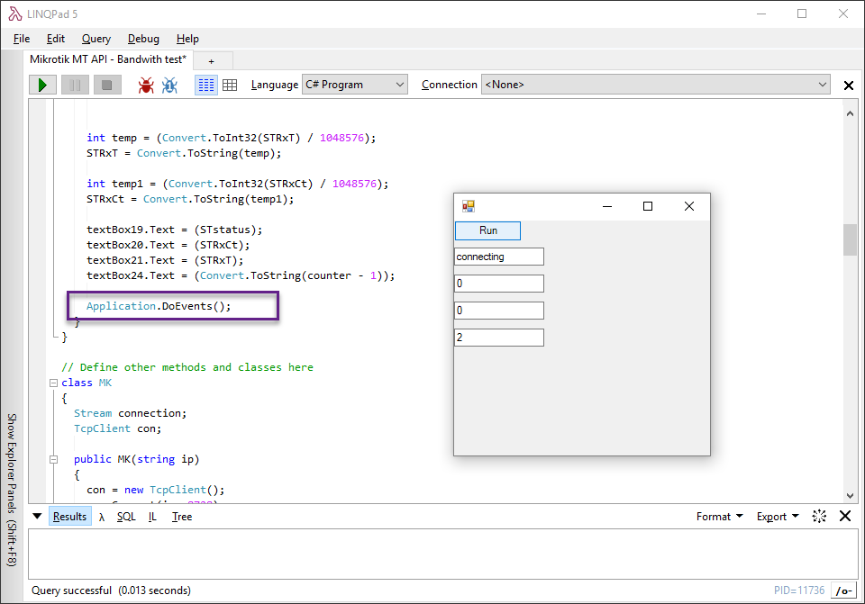

Try this after setting control values:
System.Windows.Forms.Application.DoEvents();
This allows the screen to update.
Source:
http://share.linqpad.net/334xk5.linq
Screen shot:
yes !
now it’s working
Thank you vety much!
