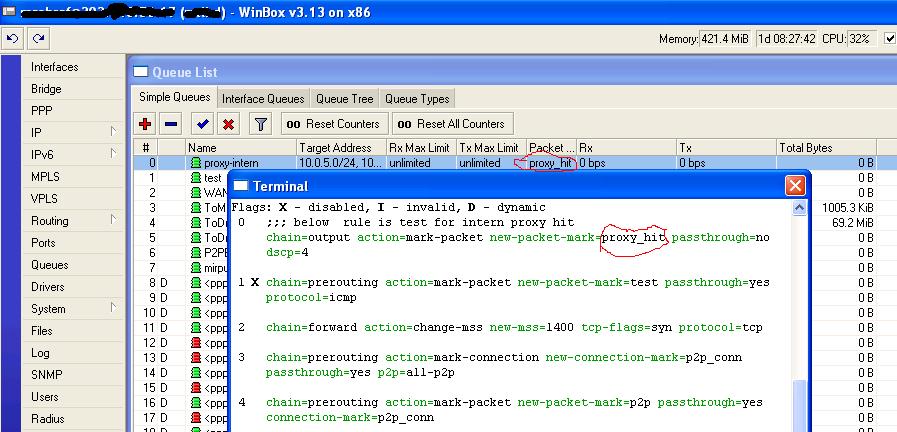

i have 400 pppoe users. But i need help to make mangle rule which will mark the cached packet. then i will make a simple queue & put it at the first with unlimited bandwidth. May be it will help pppoe users to get access cached without queue limit.
can anyone plz help me abt the mangle rule???
thnxs,
raktim
i have tried but failed…
is it right way???
what queue type did you set for selected rule?
if default-small, try change it to default
just simple queue..
can u plz tell me da difference between default-small & default
thnxs,
raktim

beny30, if you use PPPoE, try just setup bandwidth in Profile, and then mark output having dscp=4 with some packet mark, so it go round the PPPoE’s dynamic queues
the example you pointed is for direct WAN access or Hotspot, I think
I have three interfaces: WAN, LAN (LAN1 and LAN2) bridge.
plus one interface per PPPoE user :wink:
so try to do what I said
I did it, it counts now too slow but if you look for a long time you see that the numbers change. Do I need to set any simple queue for unlimited traffic from the cache, how to check if they get files faster with LAN speed, how can I check if there are files in the cache?
