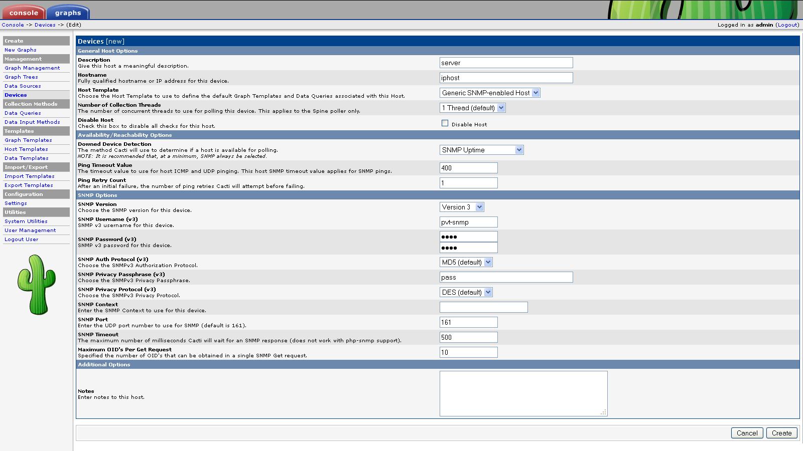

Hi guys i’ve this issue with cacti.
The configuration that I use on my server is the follow:
/snmp community
set [ find default=yes ] authentication-password=pass encryption-password=
pass
add addresses=“IPcacti” authentication-password=pass
name=pvt-snmp security=authorized
/snmp
set contact=info@me.com enabled=yes location=USA
trap-community=pvt-snmp trap-target=“IPcacti” trap-version=3
So, the configuration host on cacti is the follow like in picture:
Where:
SNMP username:pvt-snmp
SNMP password:pass
SNMP passphrase:pass
When I finish to add this configuration appear the error: snmp error
Where I wrong?
If setting up the host with version 1 I have not problem…
Thanks for support
S.
