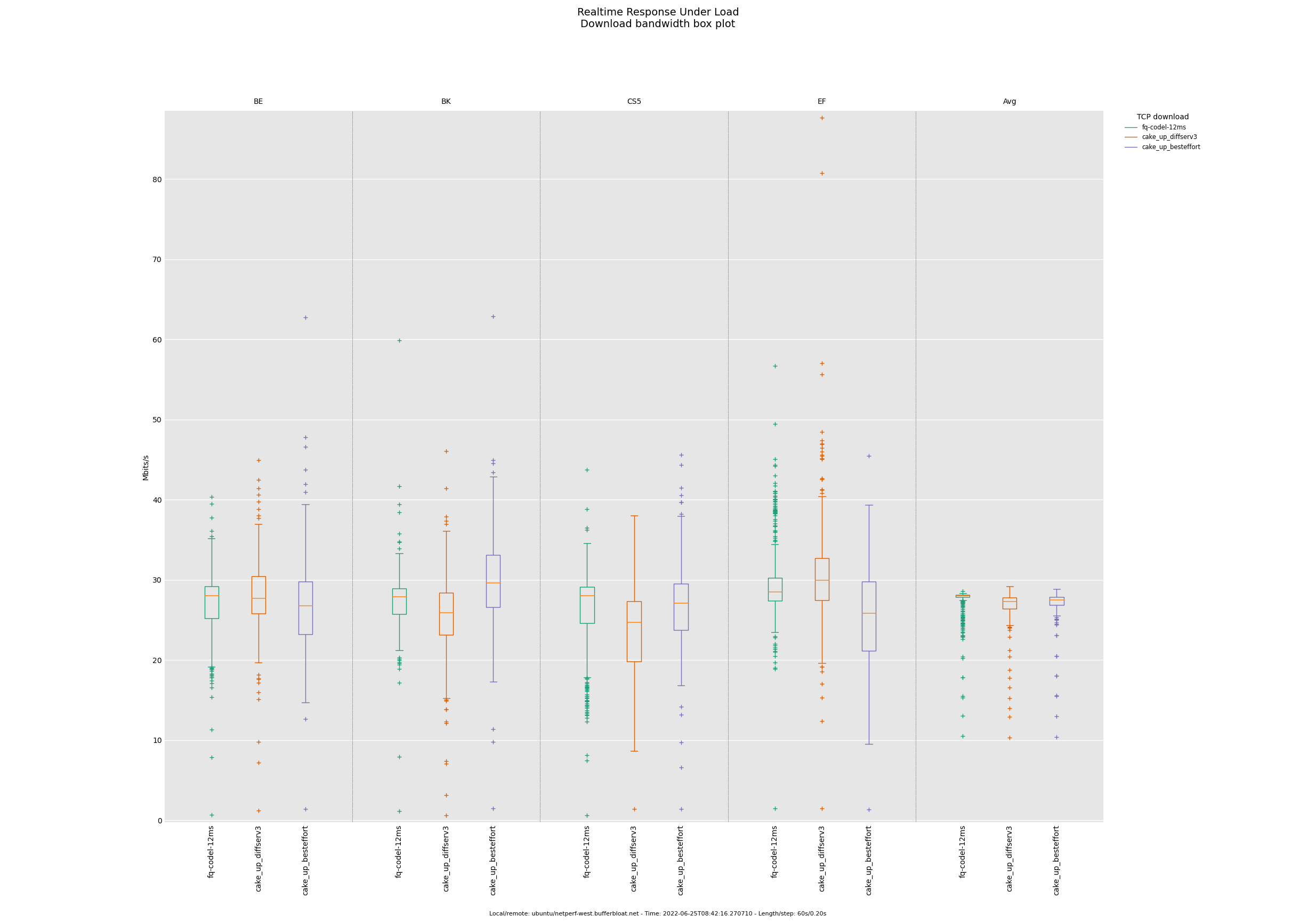

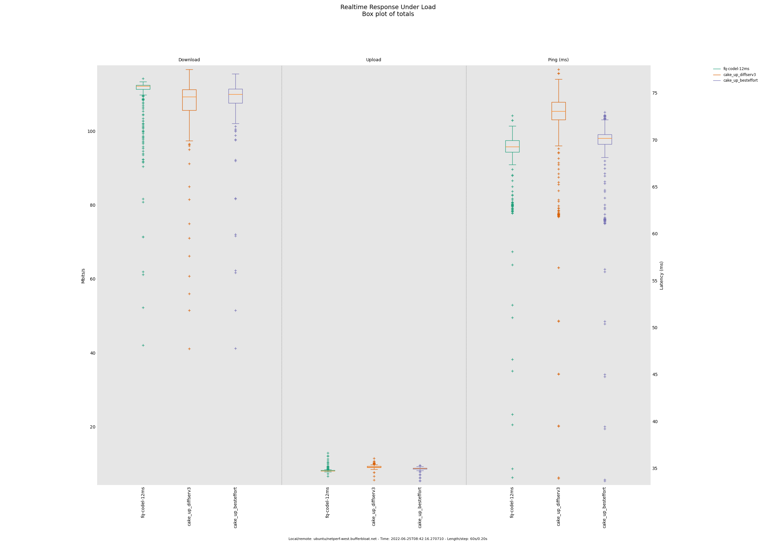

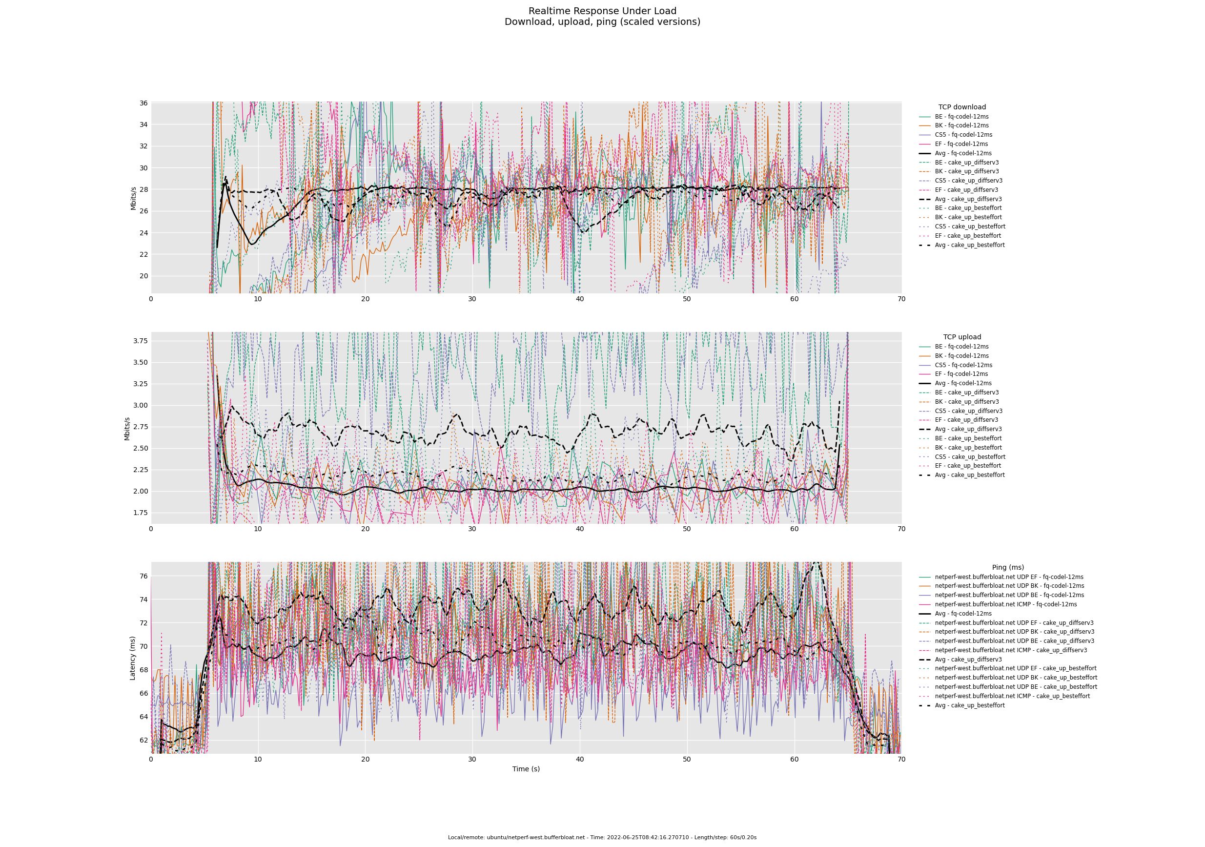

In all my tests with Waveform and Flent I could never get cake to show better numbers than fq-codel, so the latter is my preferred choice for now. Only upload bandwidth was slightly better, but latency under load was worse. There are dozen ways one can configure queues, so the results might be different with different configuration or scenarios. Note that I’m using interface HTB (as opposed to global) which allows me to leave fasttrack enabled. I found that queue themselves are not using that much CPU (for my bandwidth), but it’s fasttrack being enabled vs disabled that makes a huge difference for CPU.

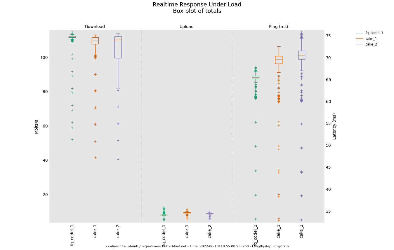

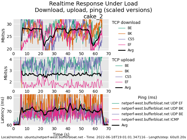

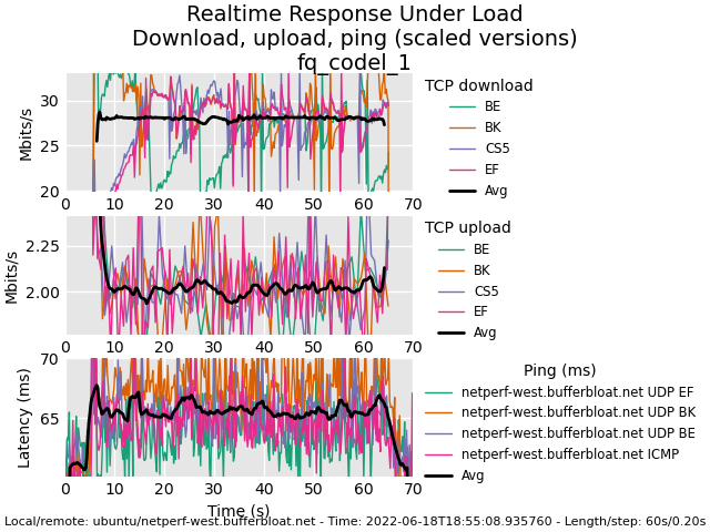

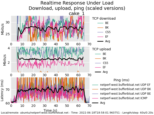

Attached are some graphs from the Flent tool, which also allows to compare them side by side. It would be great to see more results from other users. I found examples in other threads very helpful when trying this out.
Cake configuration
/queue type
add cake-ack-filter=filter cake-flowmode=dual-srchost cake-mpu=64 cake-nat=yes cake-overhead=18 cake-overhead-scheme=docsis kind=cake name=cake-up
add cake-diffserv=besteffort cake-flowmode=dual-dsthost cake-mpu=64 cake-overhead=18 cake-overhead-scheme=docsis kind=cake name=cake-down
/queue tree
add bucket-size=0.01 max-limit=118M name=download packet-mark=no-mark parent=bridge1 queue=cake-down
add bucket-size=0.01 max-limit=11M name=upload packet-mark=no-mark parent=ether1 queue=cake-up
Cake 2 on the graphs is the same, only flowmode is set to triple-isolate for both directions.

Very good post. However the reason why you see worse udp BK ping latency and a worse average latency on the rrul test cdf for cake is that the foreground tcp traffic is getting more priority than the background traffic, which is actually what you want. The rrul_be test, or using cake besteffort, would probably show equivalence. cake’s integral shaper is better than htb + fq_codel, but in this environment cannot be easily used. The principal features of cake are per-host fairness, ack-filtering, the integral shaper, and diffserv support. If you don’t need those (and in many circumstances you don’t), use fq_codel instead.
Testing for per host fairness is in the flent rtt_fair_var tests. -H A -H B -H A -H A would show machine “B” getting roughly the same amount of bandwidth as machine A.
Ironically the ack-filter mode is giving you, oh, about 15% ? more upload bandwidth at this level of asymmetry but this comes at a cost of measured latency on this test (as there are less small packets to interleave). ack-filtering is increasingly important above 10x1, absolutely necessary at 20x1 or higher down/up ratios.
fq_codel & cake share more or less the same basic FQ and AQM algorithms. Cobalt (cake’s derivative of codel) is mildly more accurate, and has some protections against unresponsive traffic that fq_codel doesn’t.
My first goal has generally been to replace all the FIFOs and REDs and the SFQs of the world with fq_codel derived algorithms, and I am perversely glad y’all think the battle is between fq_codel and cake. :slight_smile: I’d really like more to try fq_codel or cake running natively on an interface without a bandwidth parameter or shaper… and on simpler tests than the rrul or rtt_fair tests.
The cake_2 plot above seems to show that something went wrong twice during the test - either there was other traffic, or something glitched somewhere. Doing a comparison plot of that test run will show lower bandwidth and higher latency - this is why we show the detailed results first before going to produce the summary cdf or bar chart.
cake IS more cpu intensive than fq_codel, so it ALSO is entirely possible it glitched, too! If it’s reliably glitching and fq_codel isn’t, well, that’s a good datapoint. Trying to debug or improve matters from where I sit has been difficult, and I am loving more folk doing more and more benchmarks with flent.

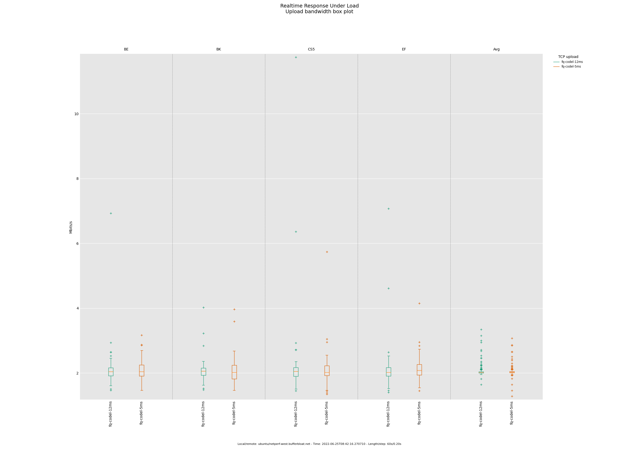

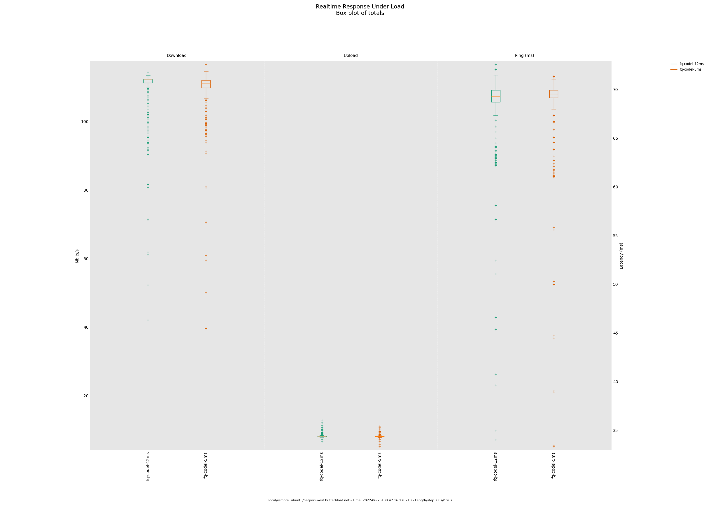

fq-codel-target=12ms should not be needed at speeds > 4Mbit. 5ms is the default. However does this make any difference on throughput for you?

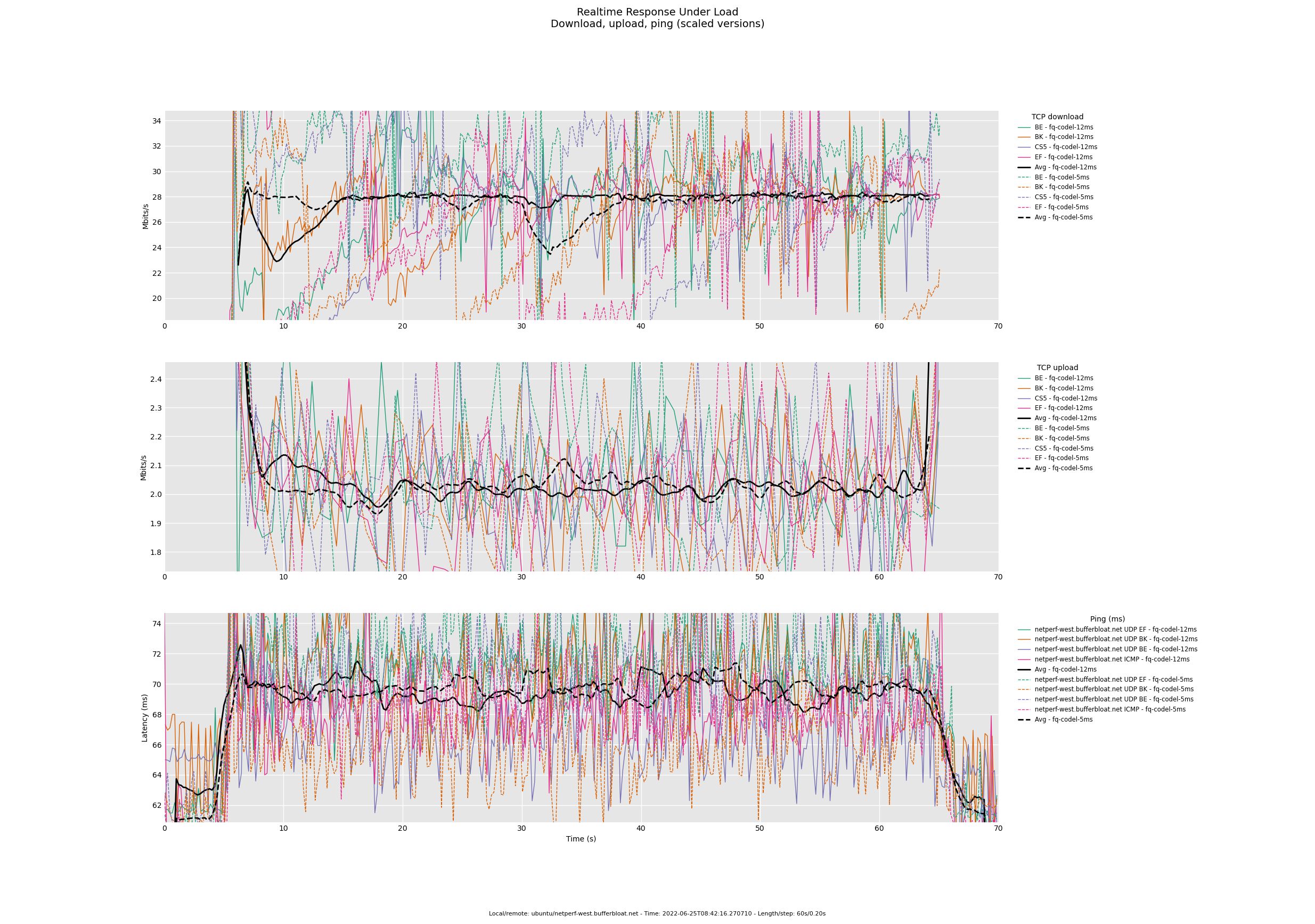

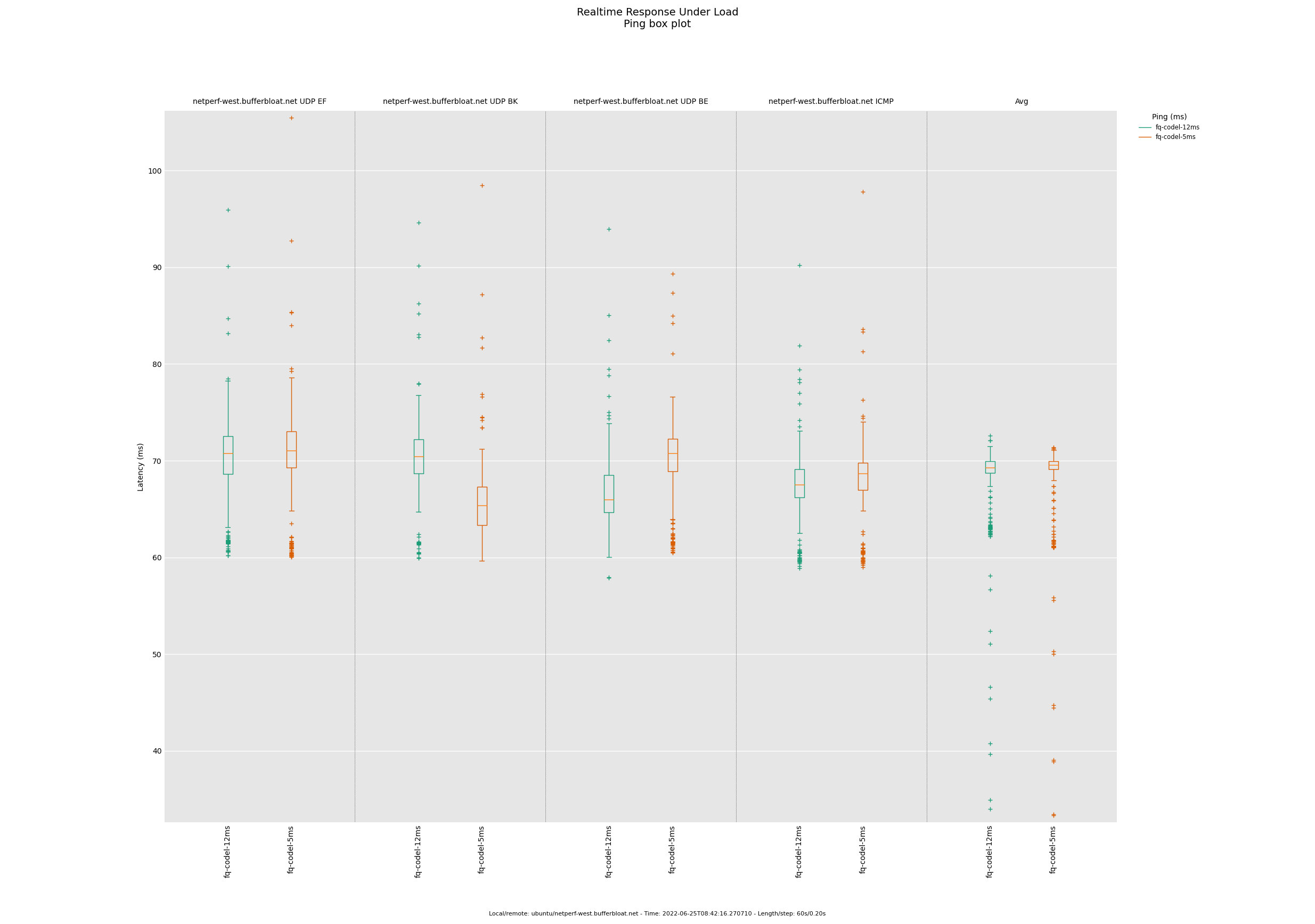

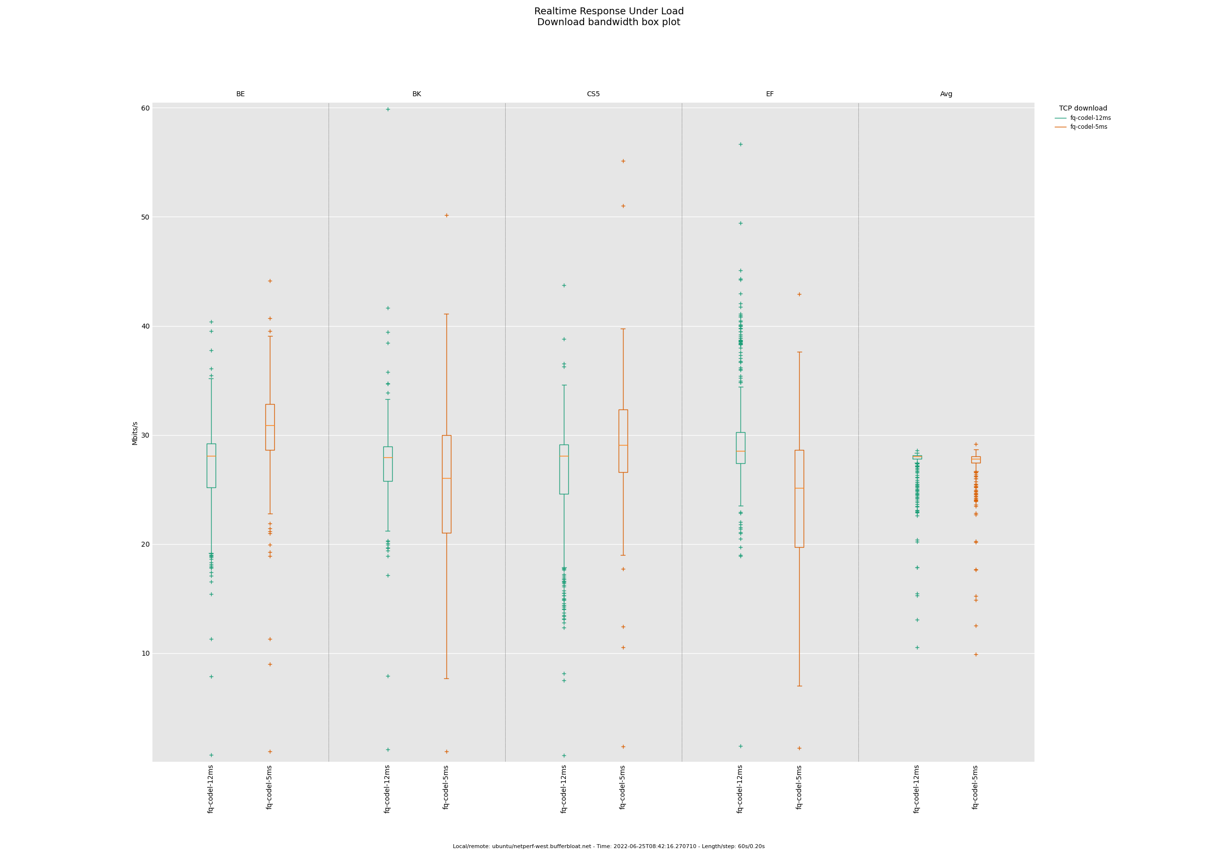

Here are more tests. I will split them into several posts for better organization. The plots were generated on a 4K monitor with high DPI, so not sure how they would look like on lower DPI screens. The font might be a bit small, but better resolution overall, so the plots could be zoomed in.
The 12ms for fq-codel was from a recommendation I read somewhere. My unloaded pings to ISP default gateway are 9-11ms, so targeting lower latency didn’t make sense. At least that is the explanation I read, clearly it could be wrong. It doesn’t look like there is much of a difference.
Fq-codel setttings for all tests below. The 5ms target is as indicated on the plots.
/queue type
add fq-codel-limit=1000 fq-codel-quantum=300 fq-codel-target=12ms kind=fq-codel name=fq-codel
/queue tree
add bucket-size=0.01 max-limit=118M name=download packet-mark=no-mark parent=bridge1 queue=fq-codel
add bucket-size=0.01 max-limit=11M name=upload packet-mark=no-mark parent=ether1 queue=fq-codel
rrul-2022-06-25T134216.270710.fq-codel-12ms.flent.gz (114 KB)
rrul-2022-06-25T134535.470270.fq-codel-5ms.flent.gz (115 KB)

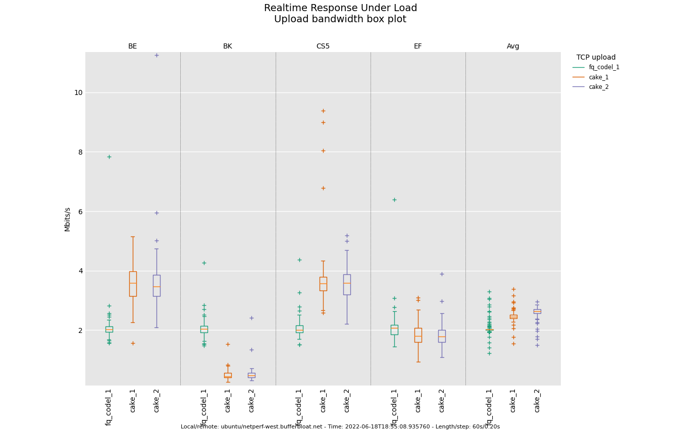

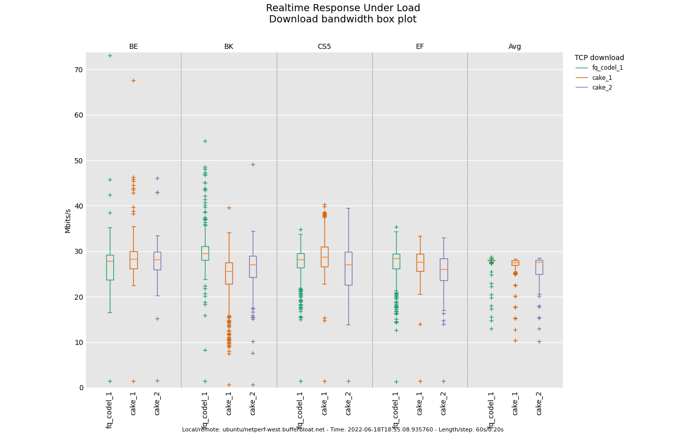

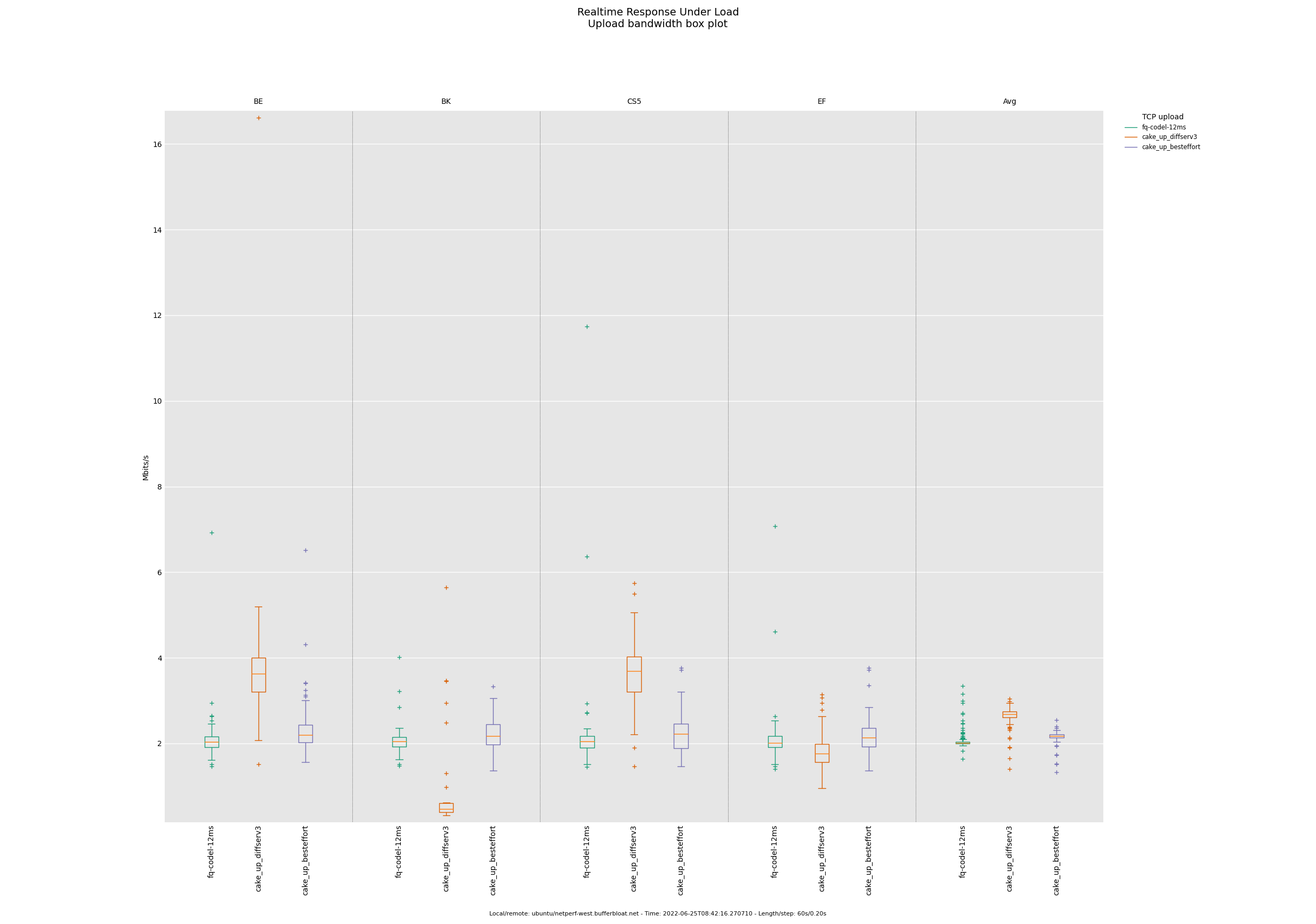

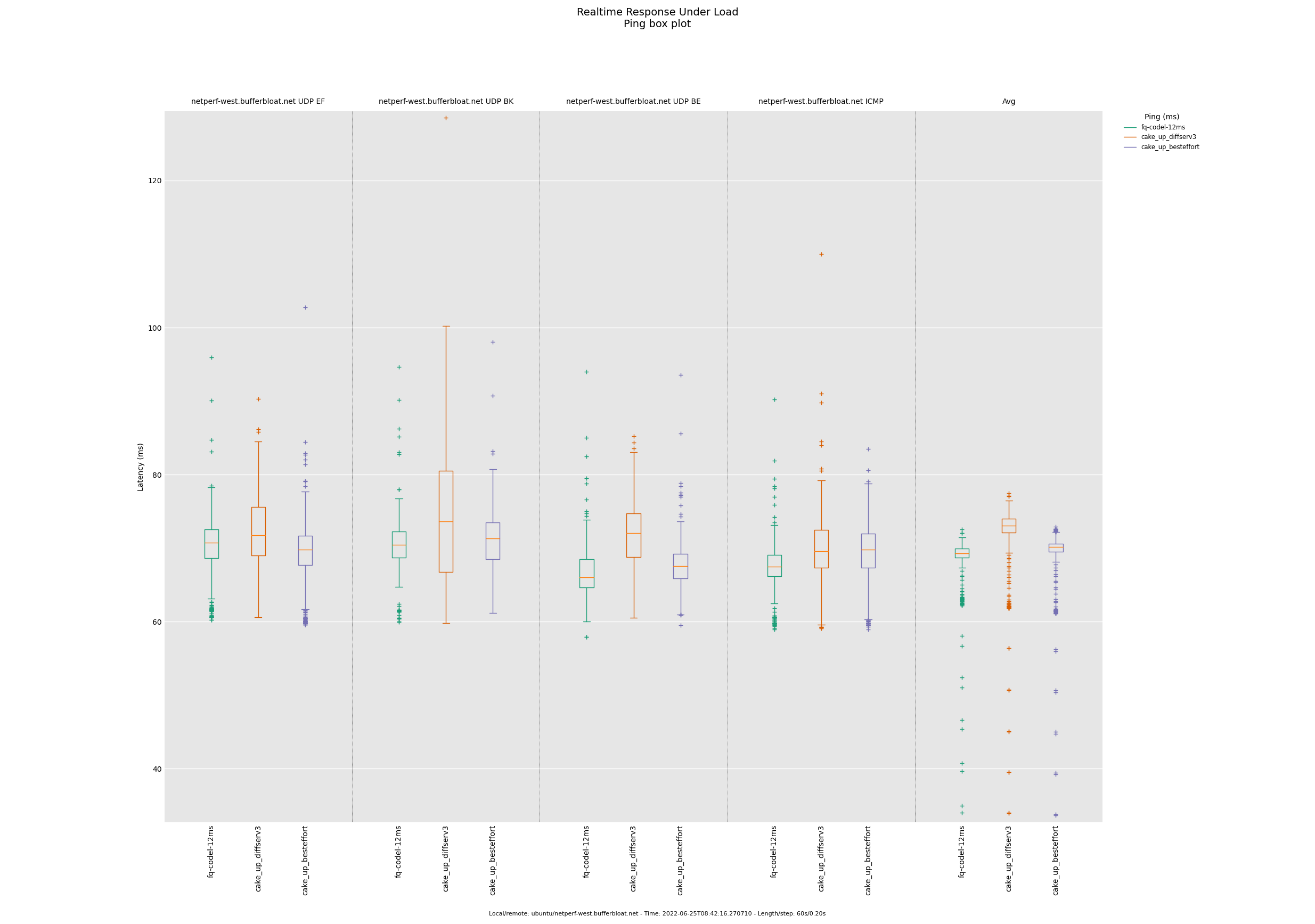

Comparison between fq-codel and cake. I didn’t use the default docsis overhead (as in my previous tests) since I read it could be 22 instead of 18. Getting it higher than needed won’t hurt too much, but getting it lower can have an impact. This is from what I read online. So I set it manually to 22.
Cake settings for all tests. Besteffort for downloads in both tests, diffserv3 or besteffort for uploads as indicated on the plots.
/queue type
add cake-ack-filter=filter cake-flowmode=dual-srchost cake-mpu=64 cake-nat=yes cake-overhead=22 kind=cake name=cake-up
add cake-diffserv=besteffort cake-flowmode=dual-dsthost cake-mpu=64 cake-overhead=22 kind=cake name=cake-down
/queue tree
rrul-2022-06-25T135148.045882.cake_up_diffserv3.flent.gz (118 KB)
rrul-2022-06-25T135344.229643.cake_up_besteffort.flent.gz (118 KB)

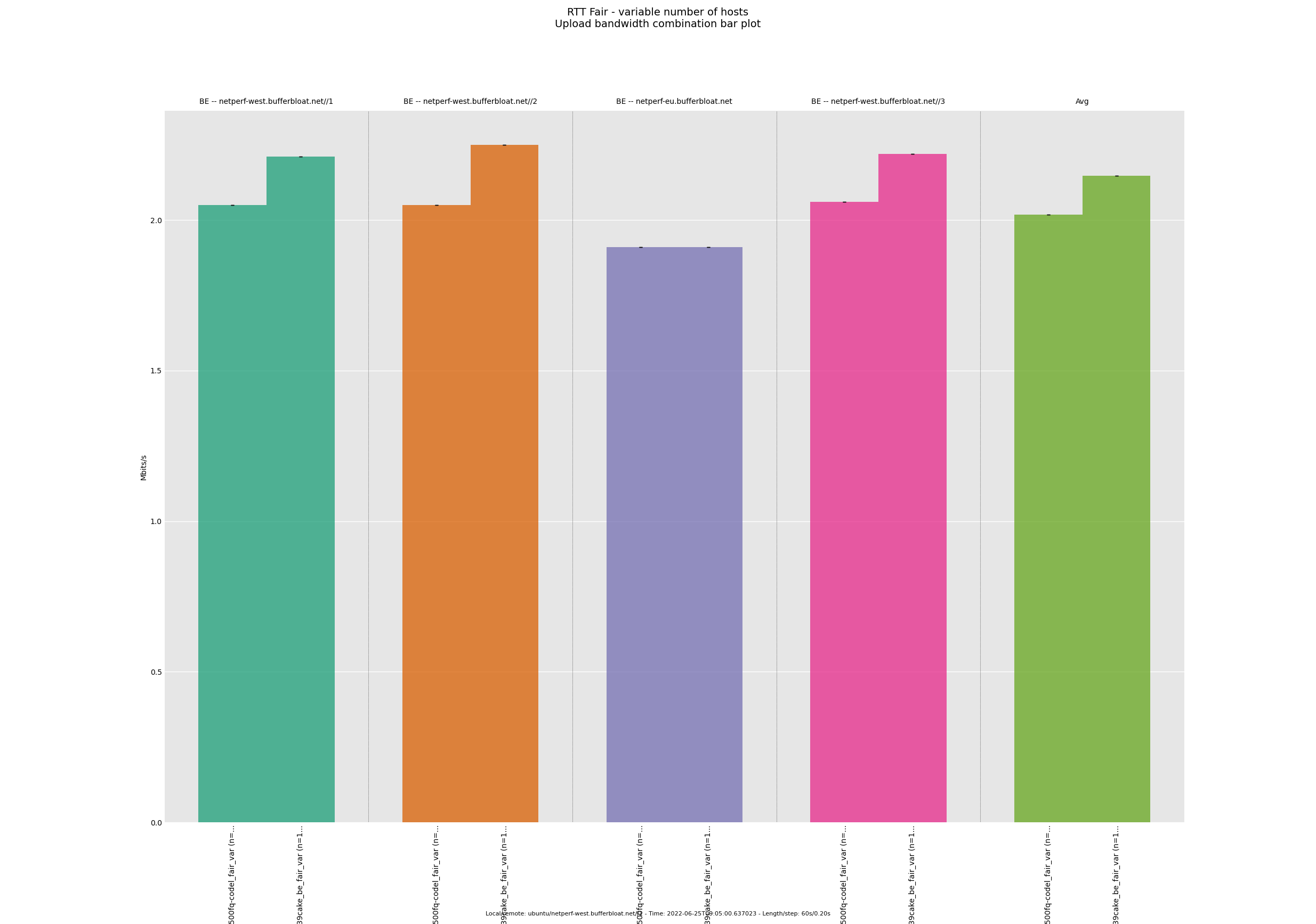

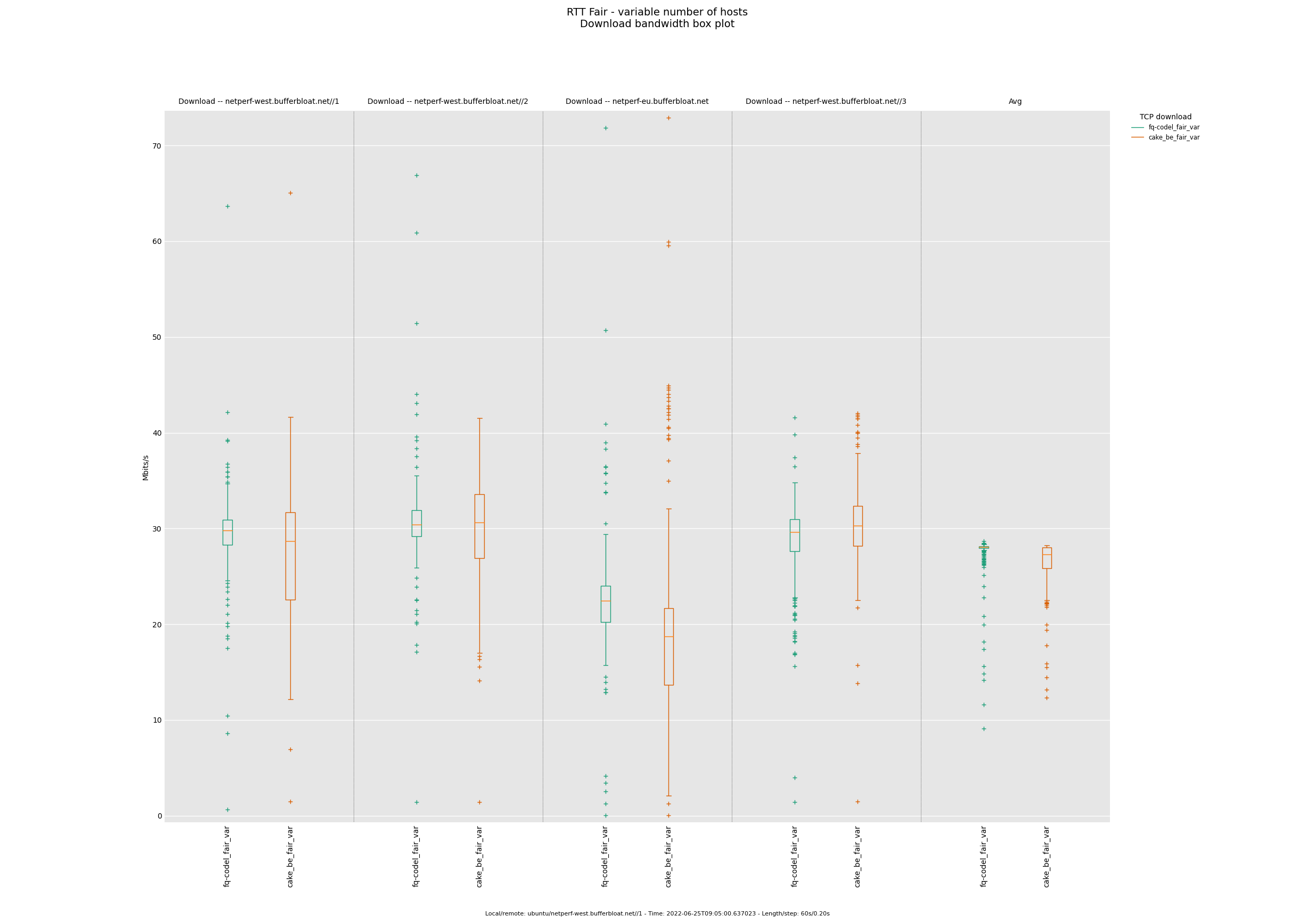

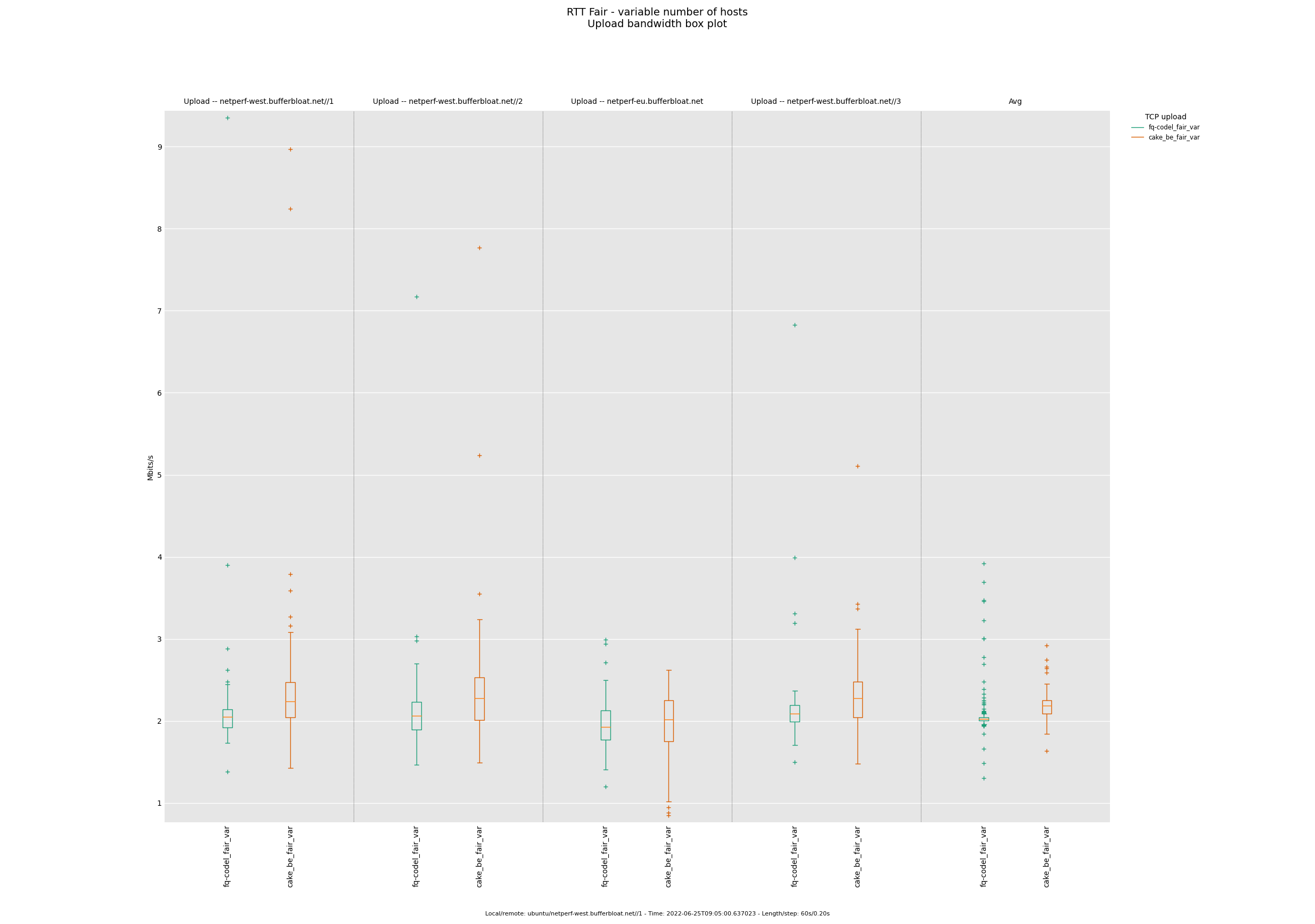

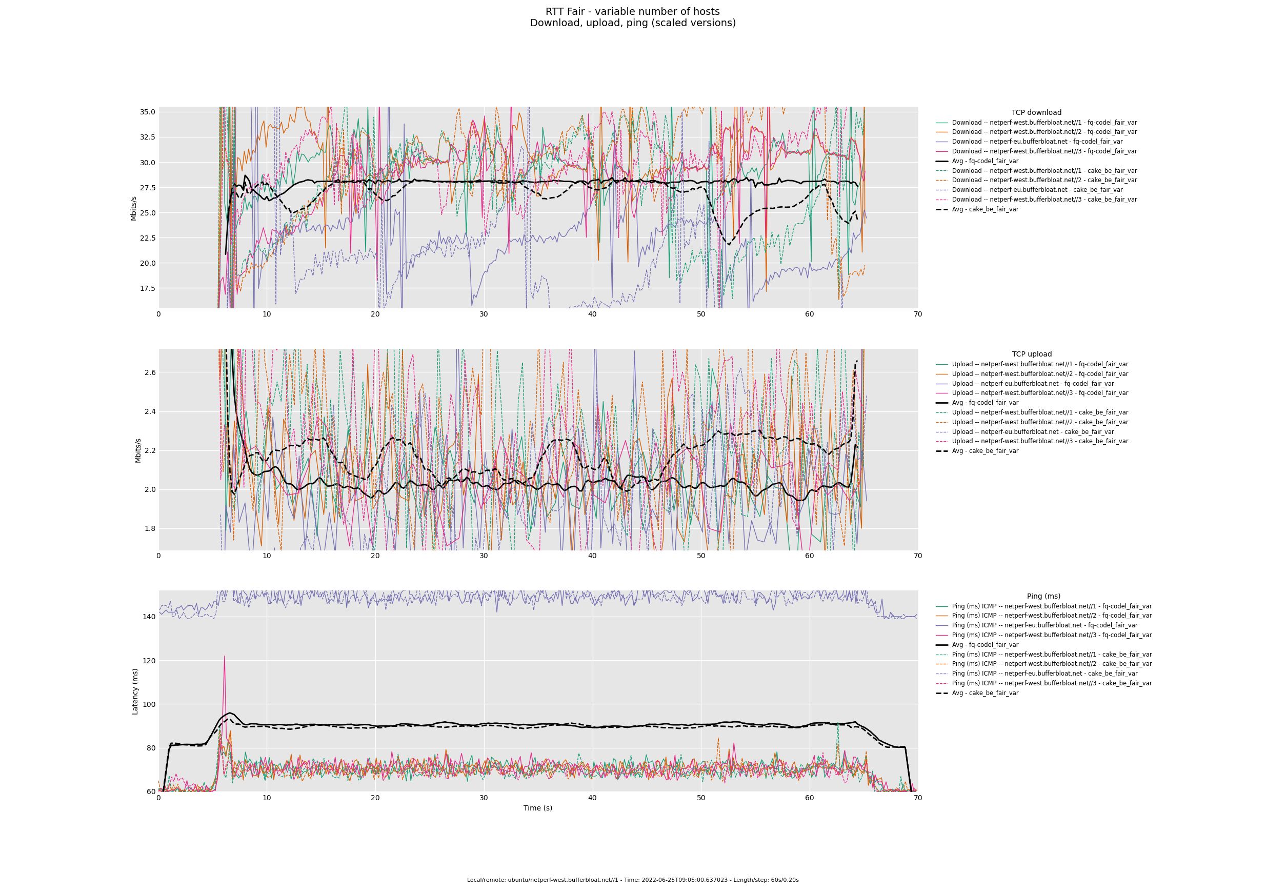

Comparison using rtt_fair_var test. I used west and eu servers as you suggested: 3 -H switches for one server, 1 -H switch for another.
I must have done something wrong because EU server gets the same bandwidth as each of the West ones. I would expect 3 West flows total get the same amount as one EU.
rtt_fair_var-2022-06-25T135839.408470.cake_be_fair_var.flent.gz (84.3 KB)
rtt_fair_var-2022-06-25T140500.637023.fq-codel_fair_var.flent.gz (82.4 KB)

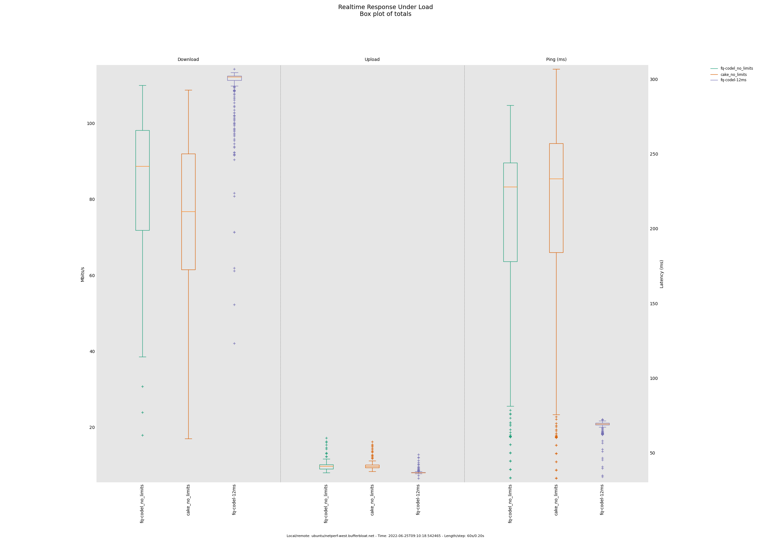

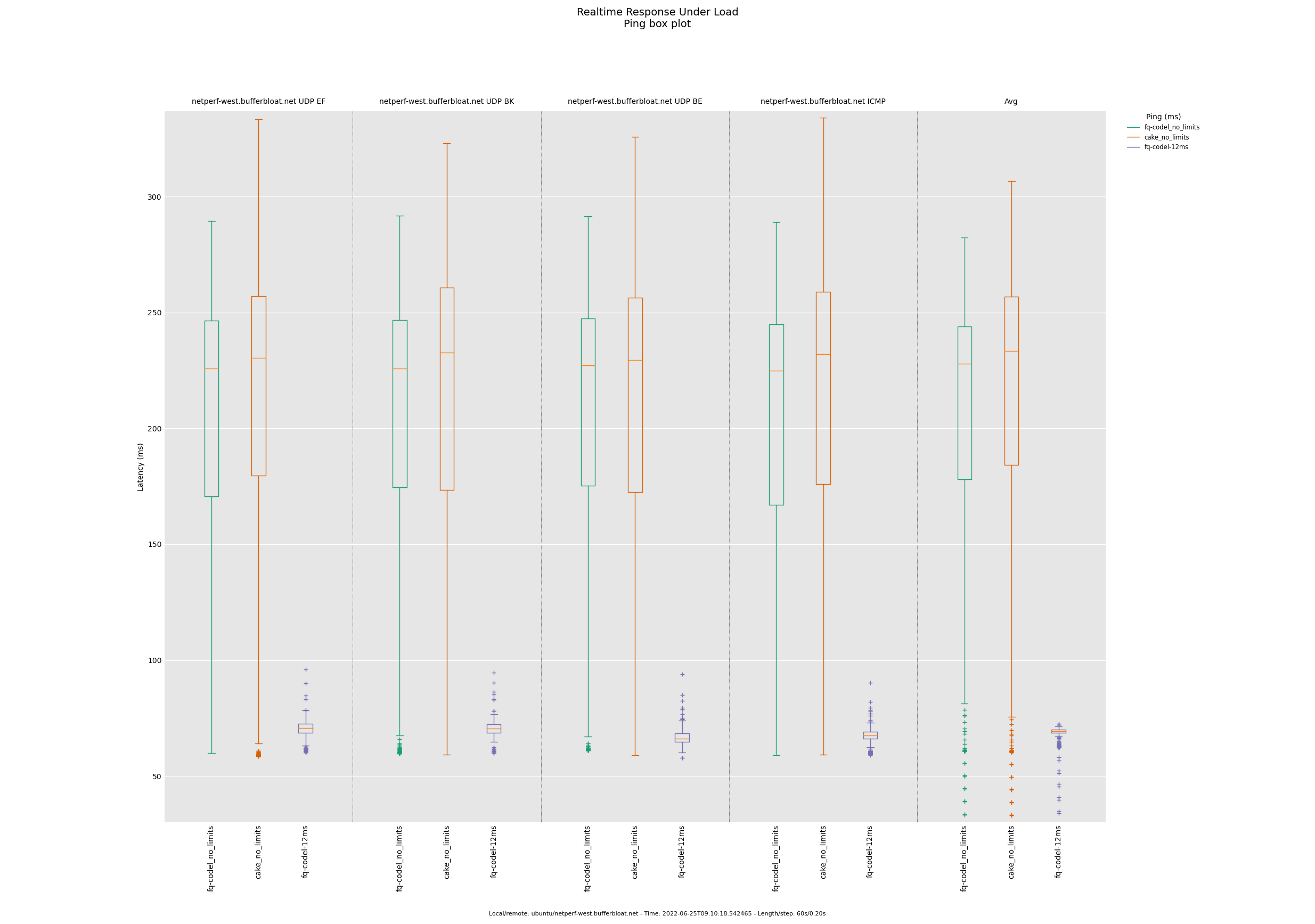

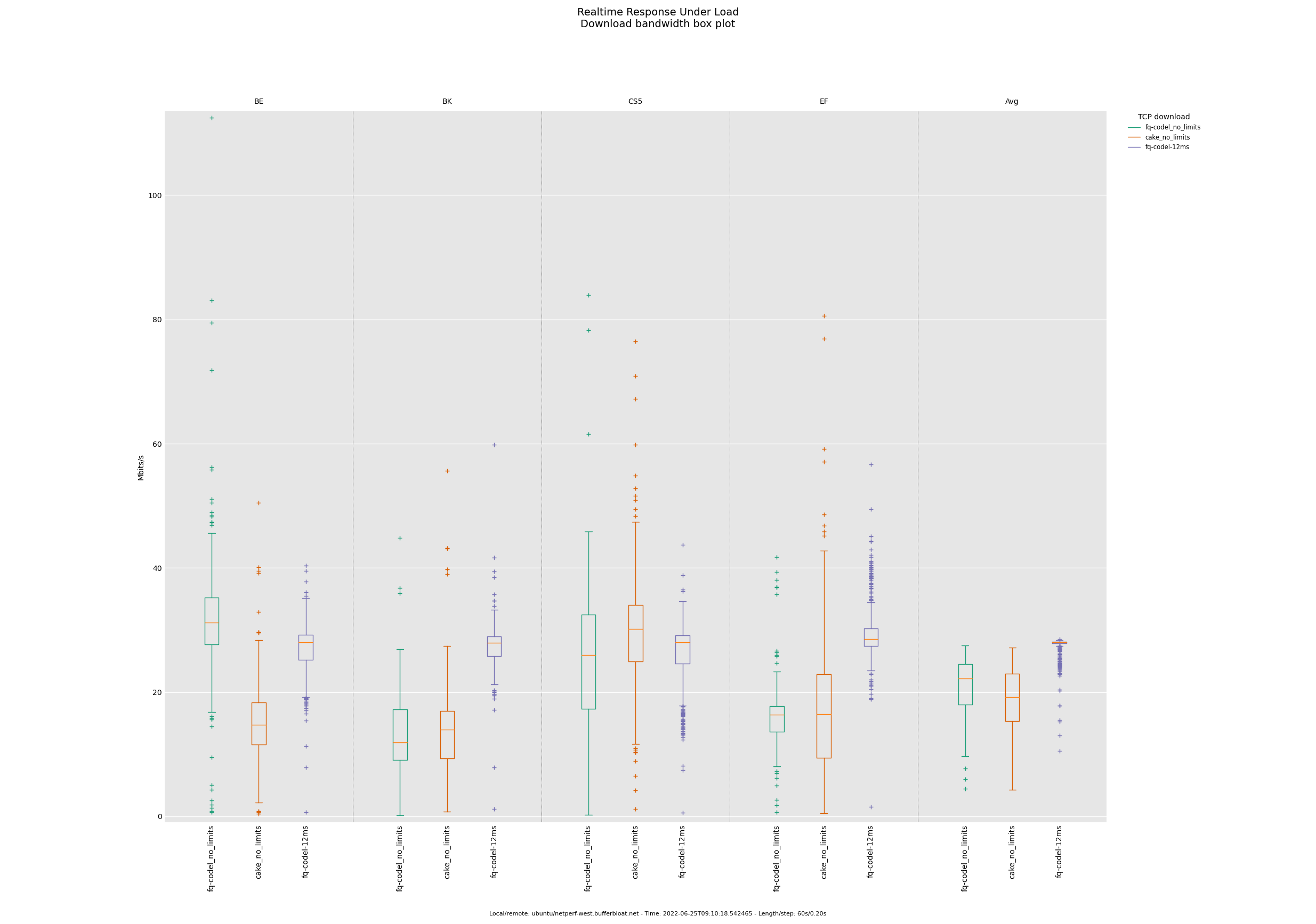

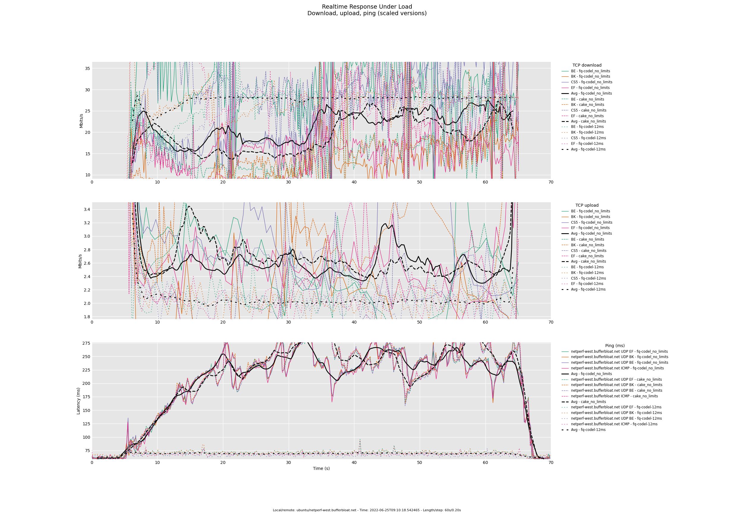

Queue trees are disabled, no bandwidth limits. Direct interface queues are used. For upload - ether1. For download I tried to use bridge (facing my LAN), but RouterOS didn’t allow it with error “failure: non rate limit queues are useless on this interface”. So for this test I put the queue on ether2 where my test PC was connected (over an unmanaged switch). This probably wouldn’t work well in real world as then all download flows would be treated independently on each ether interface. So it’s more for academic purposes.
In this test cake was using significantly more CPU than fq-codel, 2.5-3x more, although overall utilization was still pretty low, around 10%.
I also added data from fq-codel test for comparison. The no limit configuration behaves as if no queuing technologies are applied at all, latency is through the roof.
rrul-2022-06-25T141256.677726.cake_no_limits.flent.gz (120 KB)
rrul-2022-06-25T141018.542465.fq-codel_no_limits.flent.gz (120 KB)
–socket-stats will capture the tcp rtt directly for uploads and supply plot options to look at (for example) the difference between target 5ms and 12ms. While you
might think you want a little more bandwidth than what you got, smaller queues lead to better behavior in the advent of a hash collision.
The codel target is for queuing delay, not path delay. The codel interval is intended to be set to oh, 98% of your maximum observed path delay, the default of 100ms has been shown to scale well to world-girdling rtts (240ms) but tends to fall off at > 280ms.

The circumstances where I was hoping for a line rate test was actually to/from a device running at line rate, not to your awful (yet typical) ISP link.

As for not seeing per host fairness, are you going through nat on this router? If so, use the nat option.
Also, triple-isolate.

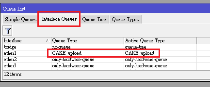

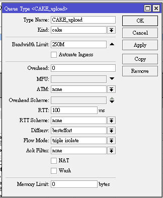

I think this is the correct way to use CAKE.
Just need to add CAKE on ether1 for outbound traffic and on ether2 for inbound traffic.
I can’t set CAKE on virtual bridge for downloading, but maybe adding a switch on physical ether2 works for it.
It may work better than using HTB+FQ_CODEL.

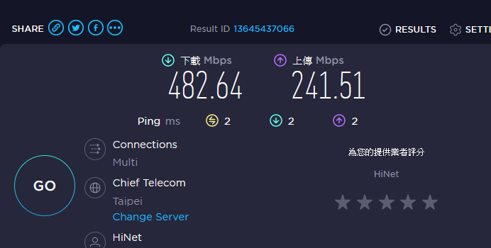

My bandwidth is 500M/250M (FTTH EPON PPPoE MTU=1492),upload=cake,download=queue tree+fq_codel↓↓
I found that CAKE’s reacting time for reducing latency in the beginning was always faster than htb+fq_codel.
Tested on AC2 with Fasttrack=Enabled.

I concur. As I understand it, CAKE should be used alone, it’s by design and has an integrated packet scheduler. I’ve got 2000Mb dl/600 Ul and I’m only using CAKE as an Interface Queue and I’m seeing much better results (less bufferbloat) and without it. Also, less CPU usage: on a CCR2004-16G, an upload test (600Mbits/s) consumes about 15% of CPU time, whereas using simple queues brings the CPU usage to about 19%.
thanks for sharing. ping was reduced, works fine
