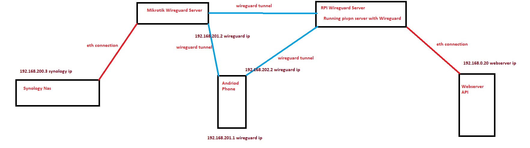

Hi all,
I would like to ask you if it’s possible to have the mikrotik router as a Wireguard server and as a Wireguard client in the same time.
Basically I have it set up as a server and it works ok to connect from android phone to a NAS behind the router.
Now I would like to add a RPI Wireguard server from another remote network and I would like to connect with the mikrotik router to that particular Wireguard server and allow connection from the webserver ip mentioned in the screenshot ( 192.168.0.20 ) to the synology nas mentioned in the screenshot ( 192.168.200.3 ). So that the synology nas collects data from the webserver api.
Please excuse my poor drawing skills :smiley:
Thank you lots in advance for all the help

hi, thank you for the response. Unfortunately I only have a mikrotik router in the first location, and on the second location I have a raspberry pi. So maybe I misunderstood or I am too new at this :confused:
In the WireGuard world of VPN’s there is no such thing as Client/Server … WireGuard is strictly Peer to Peer … Any WireGuard Peer can communicate with any other WireGuard Peer … A Peer does not talk to itself … a Peer only communicates with it’s other permitted Peers …
So your Raspberry WireGuard Peer can establish communications with your MikroTik Peer as long as you exchange the proper keys and have the allowed addresses in place and your Firewall is correctly configured to allow the communication.

Understood, but how can I make sure the mikrotik is the one connecting to the rpi? Meaning, how can he be the one initiating the connection?

I don’t know what I should configure more or how it should look. Any help is much appreciated here

I see that you have a second wireguard interface setup on the RPI, for android access probably not a bad idea but are you saying that both Devices have publicly accessible WAN IPs?
The important addition to android phone connectivity is the ability for the NAS server and the webservers to
a. be accessible via firewall rules L3
b. or do something automatically like stream or read traffic, or something at L2??
The mikrotik has a WAN IP, but the rpi does not. It’s behind a router with port forward.
