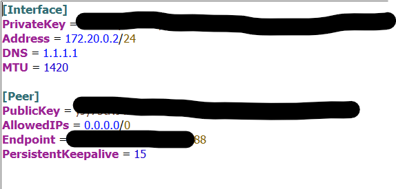

I created two tunnels. The first one is working normally with internet access. The second one only shows received packets, but no packets are being transmitted.
here is my config for both tunnels
*Both peer use the same port *
First one
[Interface]
PrivateKey =
Address = 172.44.0.6/24
DNS = 1.1.1.1
MTU = 1420
[Peer]
PublicKey =
AllowedIPs = 0.0.0.0/0
Endpoint = x.x.x.x:50.x.x.x
PersistentKeepalive = 15
The second one
[Interface]
PrivateKey =
Address = 172.44.0.4/24
DNS = 1.1.1.1
MTU = 1420
[Peer]
PublicKey =
It goes without saying that you shouldn’t share keys, especially the private sides. Regenerate them once your config is working correctly.
I have no idea what this means:
Other then that, the fact that you are receiving packets correctly usually means that the Mikrotik-side config is incorrect. Show it, without that I can only guess as to what exactly is wrong, but the usual one is misconfiguration of the allowed-ips field. For the first peer it should be 172.144.0.6/32, for the second 172.44.0.4/32

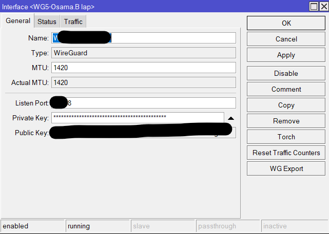

So, I encountered the following problem:
First, I created a WireGuard tunnel with only one peer, and the connection worked well.
Then, when I added another peer to the same interface, the connection stopped working.
It seems that the connection only works for one peer at a time.
Is there anything I need to enable or configure to make the connection work for both peers?
here is the config for both peer and interface
the first peer
the seconf one on my mobile phone and have the allowed ip
172.20.0.3/24
from mikrotik side its
so one interface on Mikrotik with two peers.
When I disable the second peer on mikrotik the first peer work well like the first time before I add the second one.

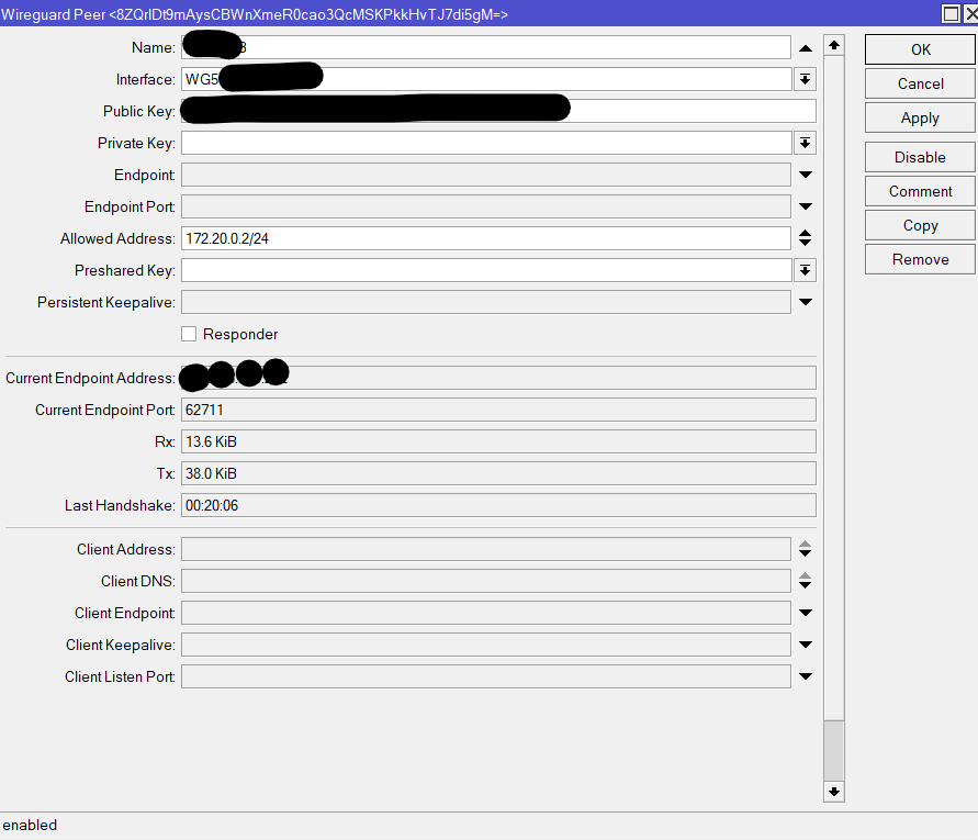

Make sure on Mikrotik side the peers are configured on allowed ip with /32 as indicated above.
from mikrotik side
here is the first peer
and here is the next one
/24 is NOT /32

Since BOTH Lurker888 and Holvoeth told you explicitly to use a /32 for those peers addresses, I would start suspecting that using a /32 is needed.
Basically:
172.20.0.2/24 means ANY IP address in range 172.20.0.0-172.20.0.255
172.20.0.3/24 means ANY IP address in range 172.20.0.0-172.20.0.255
Whilst:
172.20.0.2/32 means ONLY IP 172.20.0.2
172.20.0.3/32 means ONLY IP 172.20.0.3
Exactly.
Look at it from another way…
If you put /24, you allow the complete subnet.
How does the server ( term used for ease of explanation) know then where to send a packet to ?
With /32 there is no confusion. It’s that address and nothing else.
On peer side, you can use /24 since everything from that subnet has to go into the tunnel.

No.
IP address on interface needs to be /24.
Everything your router sees for that subnet, needs to go to that interface.
For peers they need to be /32 so there is no misunderstanding which traffic needs to go to which peer.
On client side they can be kept as /24. There is no possibility for confusion there.
I tried as you mention, still one of them work but the other doesn’t
Wireguard interface IP /24
both peer in the router /32
both peer outside the router /24
one of them work like normal bit the other not.
