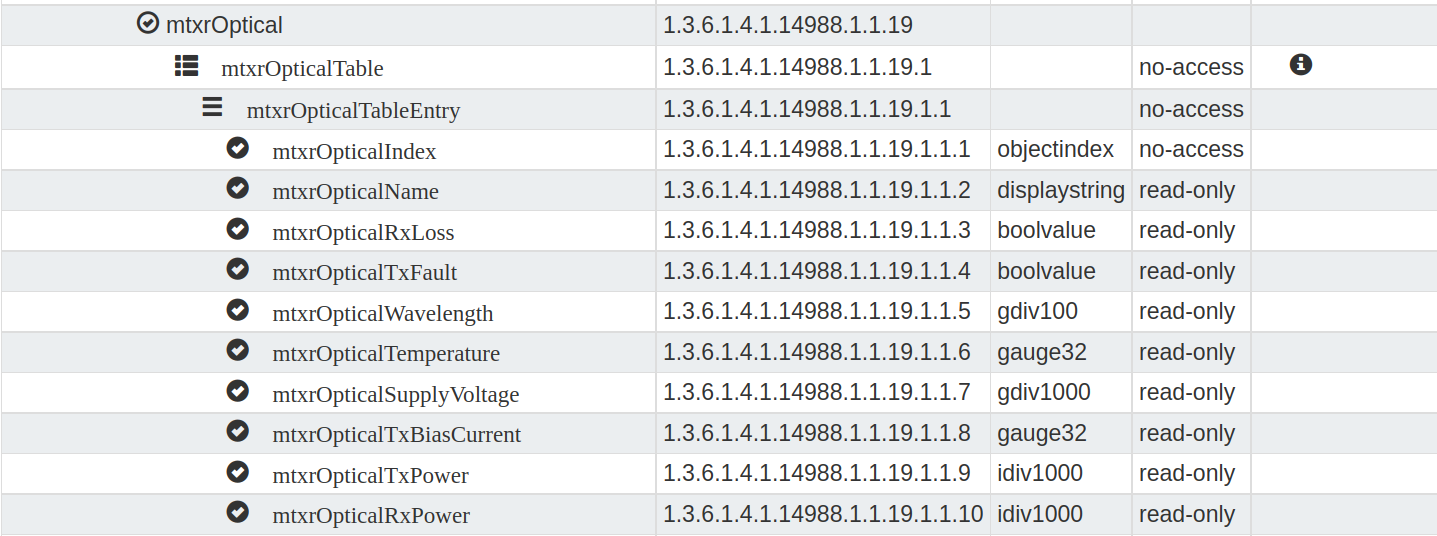

Surely if that was a duplex transceiver, surely there iwould be some way to have those first 3 checkboxes alert someone to the RX LOSE?
Well, SNMP-wise, IF the implementation is done bugfree (to be tested) you can read various parameters out according to MIKROTIK-MIB
I don’t think the MT will send out an SNMP “trap” if Rx/Tx falls under certain threshold. Probably it WILL if the whole interface goes “down”
You really need to experiment with that to see if you get these results.
Alternatively, there are probably small scripts that you can run for lets say every 30seconds that simply look at the Tx/Rx power values. If the value is out-of-range the Mikrotik could alarm you via logmessages, mail, etc,etc But again that means you need Internet connectivity (out-of-band) on every location you service.
This script would be a very simple one.
