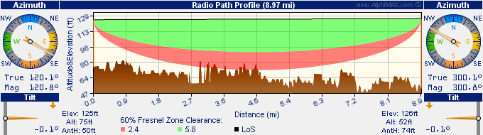

can any one explain why 2.4 works and 5.8 does not
please check the image taken for the link
the location is working fine since last 1 year with 411 board and cheap alpha cards(22dbi setting) 24dbi grid ant
but i have already tried metal 5Shpn 30dbi grid ant and was even unable to detect a signal at the other end
what is the issue
maybe trees?
no trees man it’s clear LoS
