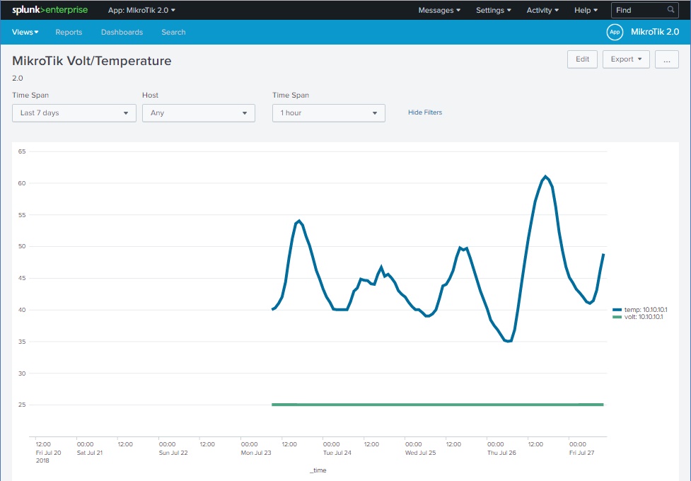

I do use script to send out using syslog, voltage/temperature and other option.
You can change the scheduler to send out at what hour you like, I do send info every 5 min.
Then I do use Splunk to graph everything.
Look at link in my signature to see how to use Mikrotik->Syslog->Splunk
Example on graph showing voltage and temperature.
