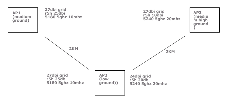

I know that 2km is too close for using 27dbi grids and 25 db cards, there is also a few tress in the way that may be causing the cq problems. AP2 is located on top of one of the company’s managers home and it is on lower ground than the surroundings.(On the river bed)

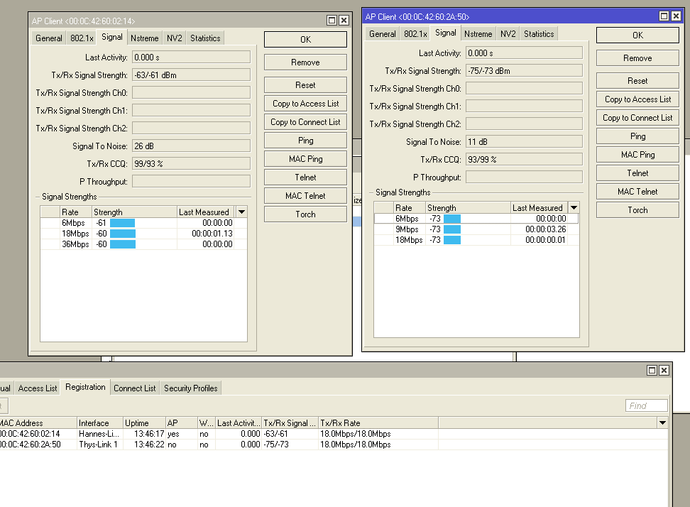

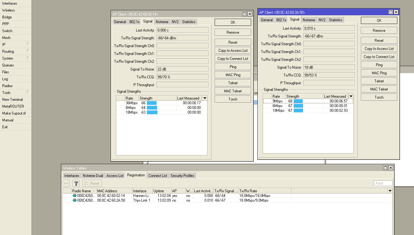

Later that day i looked at the registration table again and this is what i saw.
The signal from ap2 to ap3 has weaken a little but stil does not disconnect.
With 2Km distance with 27dbi grids my guess is signal should be low 40’s and not 60 to 70dbm range also your signal to noise ratio should be 50+ and not 11 to 28, you are using the same polarity at both ends vertical to vertical or horizontal to horizontal and check your alignment, your frequencies 5180 and 5260 are too close move further apart, what is the distance on the mast between each grid, if there is tree’s blocking or causing freznel issues then consider increasing height of mast or moving the AP’s clear LOS and no freznel zone issues is a must otherwise you have very bad AP’s?

The two grids on ap2 is about ±600mm apart.
