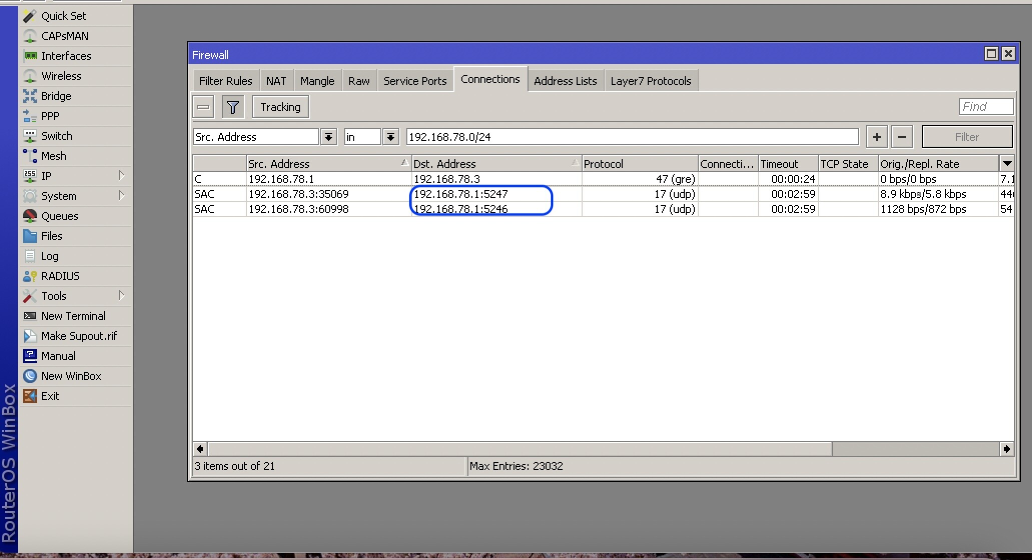

I reviewed your suggestion, but I think that’s not related to the issue after giving it a try. I could join roaming router CAP interface with HQ by using IKEv2 tunnel IP’s (CAP pointing to loopback interface in HQ, and the interfaces are up and wifi is working, with IP’s assigned). If the traffic stays local (local-forwarding=yes), no problem at all, all works as a charm. But if I try to use CAPsMAN forwarding (local-forwarding=no), even when I see the connections up and with traffic in firewall → connections, I cannot get navigation. As soon as I establish any kind of tunnel on top of IKEv2 and set this up as discover interface in CAP, the navigation works straight forward.
It must be a stupid thing I’m missing for sure, but cannot really understand why is this not working well.
In the image below you can see the two connections, data and control ports from the CAP to CAPsMAN, using IKEv2 tunnel IP’s (192.168.78.1 is loopback interface in HQ and 192.168.78.3 is mode-config IP assigned to remote roaming router):
Any other idea will be much appreciated. I start thinking on a real issue for CAPsMAN when using IP as discover method.
