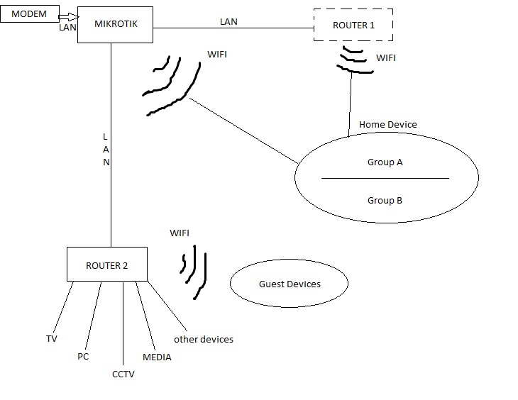

Hello, i just got my RB951G-2HND yesterday and totally blind about scripting or setup mikrotik.
This is the network plan
Here is the route:
Cable modem to Mikrotik via LAN
Mikrotik to router 1 (optional and not always available) via LAN
Mikrotik to router 2 via LAN
Mikrotik or router 1 to home devices (both group A and B) via WLAN
Router 2 to home devices via LAN not WLAN as descripted
Router 2 to guest devices via WLAN (sometimes some home devices may connect to router 2 via WLAN for some purposes)
And for the rules:
  1. I want to limit the bandwidth and block some websites or video streaming, download etc of Guest devices which connected via router 2 WLAN. If some of home devices also connected to WLAN of router 2, is it possible to prevent these home devices from the rules? I don’t want to make a list of guest devices because I have to add IP/MAC address every new device connect to my network. For rule number 1, it’s better if you could show the script to block website, media content (video and audio), stream and download.
  2. For home devices, sometimes some devices need more bandwidth. Let say group A devices are used to play game which their bandwidth can’t be disturb (example one of the device from group B is streaming video and group A got high ping). Is it possible to setup the bandwidth and also block group B from streaming,downloading etc? For this rule, I don’t want make it permanent. If possible, I just want to select it enable or disable. So when I need this rule active, I just like tick a checkbox or select enable.
    3.As you can see, router 2 have CCTV, TV and other media devices. Is it possible to block guest devices to connect to my media devices let say TV? But home devices still connect to the media devices even from router 1 or mikrotik.
And for the last, can you explain me which is the best way to configure the IP?
So far without mikrotik, I configure my router 1 with ip 192.168.1.1 and router 2 ip 192.168.1.2. For the route, the internet comes from modem to router 1 via LAN through internet port, router 1 to router 2 via LAN through Ethernet port.
What I want from the reply is the script that can configure the rules above.
A big thanks and really appreciate for your help :slight_smile:

May I ask: why the two routers? This can be done much simpler (i.e.: centrally managed) with just the RB951, a couple of VLAN capable switches and MT-based access points (e.g. hAP/wAP).
Router 2 can be used as AP if wifi range from RB951 can’t be reached or to separate network from home users and guest. Also guest wifi coverage can is less than home users coverage.
I know RB951 can setup its wifi range but the position of these two routers are different. RB951 on 3th floor and router 2 on 1st floor.
That’s not what I meant. You can still use multiple devices at different locations but you use CAPsMAN to manage them from the RB951 (together with your routing, firewall etc).
Using multiple routers in such a setup I find adding unnecessary complexity by introducing things like double NATting (unless you plan to just use the switch plane of the router in which case I was put on the wrong track by your scheme).

Actually I’m a bit confuse which is better between just use the switch plane of the router (so it will work as a switcher or LAN port extender) or make it as a router which IP let say 192.168.2.1.
For multiple routers, just ignore router 1. The main network is only the RB951 and router 2.
For CAPsMAN thing, I will try this method. Thanks for the advice.
You should use the switch plane, and only have router functionality on the main Mikrotik.
You do this with VLANs.
I assume that group A / group B is the same as home devices / guest devices on router 2… if not, then you’ll just need to add two more vlans for the groups and handle them in the same way as the guest wlan at router2…

Above setup works for the basics under the precondition that the other routers support VLANs. There is no information on the router 1 and 2, but I assume them to be non-Mikrotik.
The three specials here can be bit tricky also depending on the other hardware:
  • blocking specific websites and content is becoming increasingly difficult with HTTPS
  • the QoS → unclear whether bandwidth requirement is for ISP, wireless or both. Could be done based on MAC and/or source address/subnet with utilising queue trees and WMM. Synchronising wireless QoS on AP hardware from different manufacturers I can imagine be more tricky.
