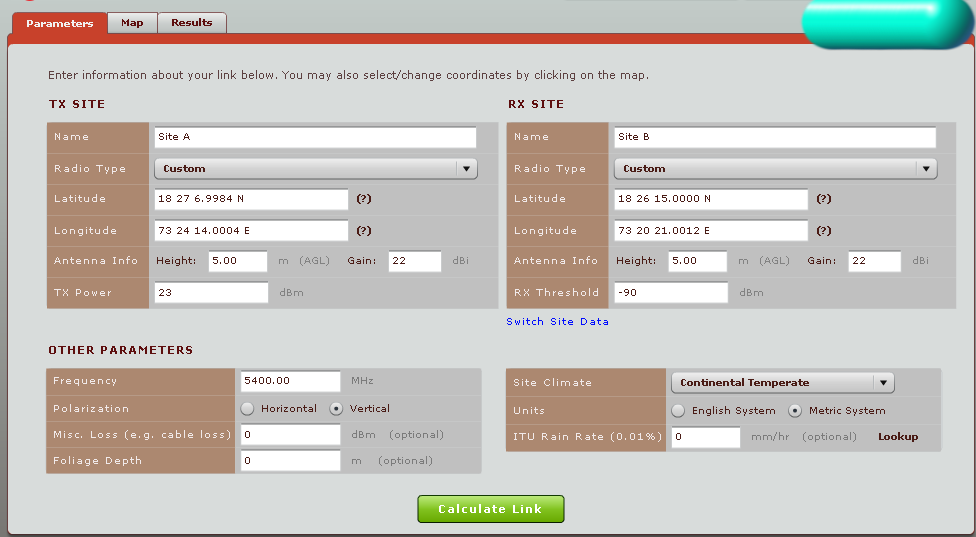

can i do 7 kms?

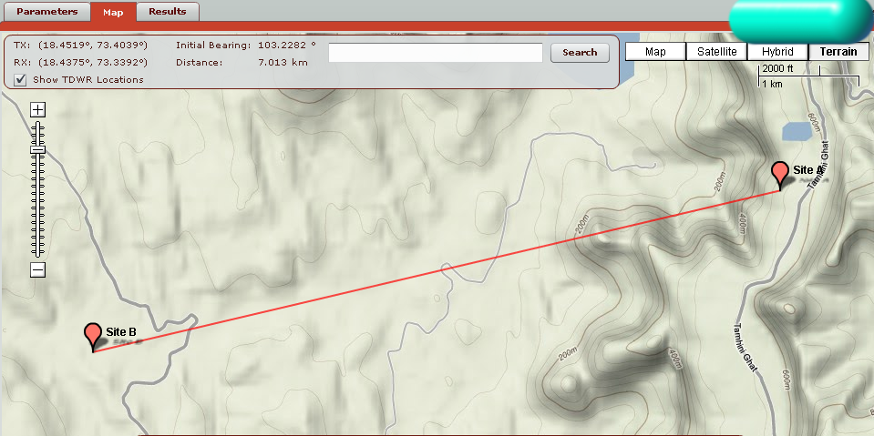

Point A → 18 27 07"N & 73 24 14"E
Point B → 18 26 15"N & 73 20 21"E
complete hilly region. i have to get internet connection at Point B and then shoot it up 561mtrs over the mountain to Point B.
will RB711A + 22dbi Patch Antenna help?? or do you suggest anything better???
help highly appreciated.
-sid

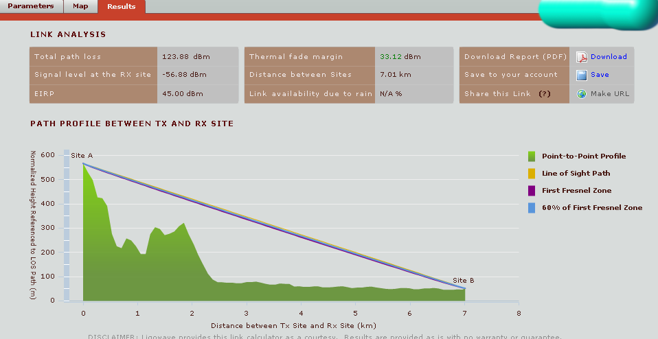

Did a quick calculation with Ligowave and results look good had to guess antenna height of 5 meters each end, 22dB grids, 23 dbm radio card power so adjust if necessary
