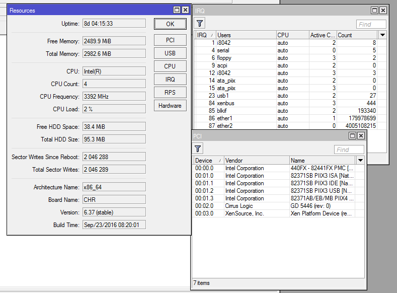

I can confirm that CHR working fine with XenServer.

Use XenServer 6.5 or newer and it will be OK…
i use here, with xen 7.2 and routerOS 6.39.2, work’s perfectly with 1gb of ram
