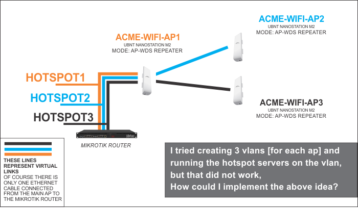

Can I run separate Hotspot servers per VLAN?
Attached diagram shows what I wish to accomplish.
The idea is just to separate the traffic per AP, so that I can see count of users connected and traffic stats per AP.
How can I accomplish this?
The APs are Nanostation M2s, they support VLAN per interface [WLAN0.LAN0, or BRIDGE0].
This can be accomplished using MAC Based VLANs, correct?
As I recall, the NanoStation will happily pass VLAN traffic and is VLAN aware for the management interface, but I’m not aware of the ability to specify which VLAN to use for locally connected stations. Note that I am using them for a point to point link with a managed switch (CSS326-24G-2S) on each end of the path. It is all VLAN tagged traffic over the MW path, but the management functions are operating on one of the VLANs just fine.
Poking through the user interface, the only reference to VLANs I can find is the management interface.

I do understand that I can run a hotspot server on a vlan. What I need to do is TAG or mark the traffic coming from a specific MAC address as VLAN500 or VLAN600 and so on
So far I have played with Switch > VLAN – no success
played with bridge> vlan -no success

Correct, it seems the nanostations only support vlans for management
