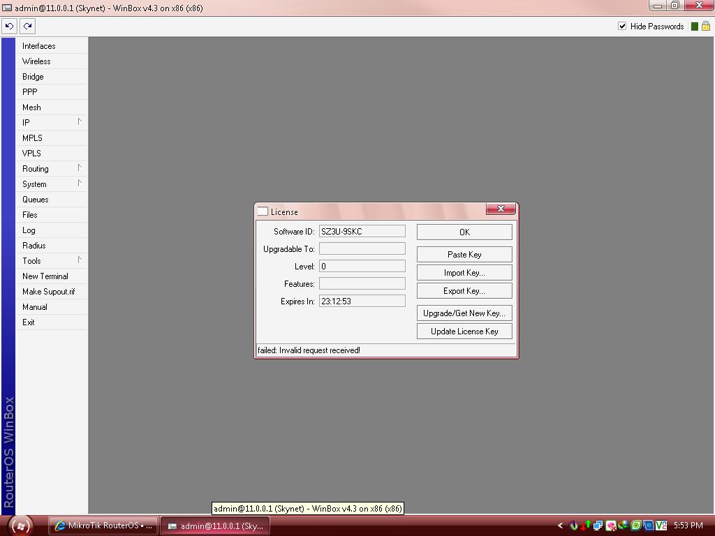

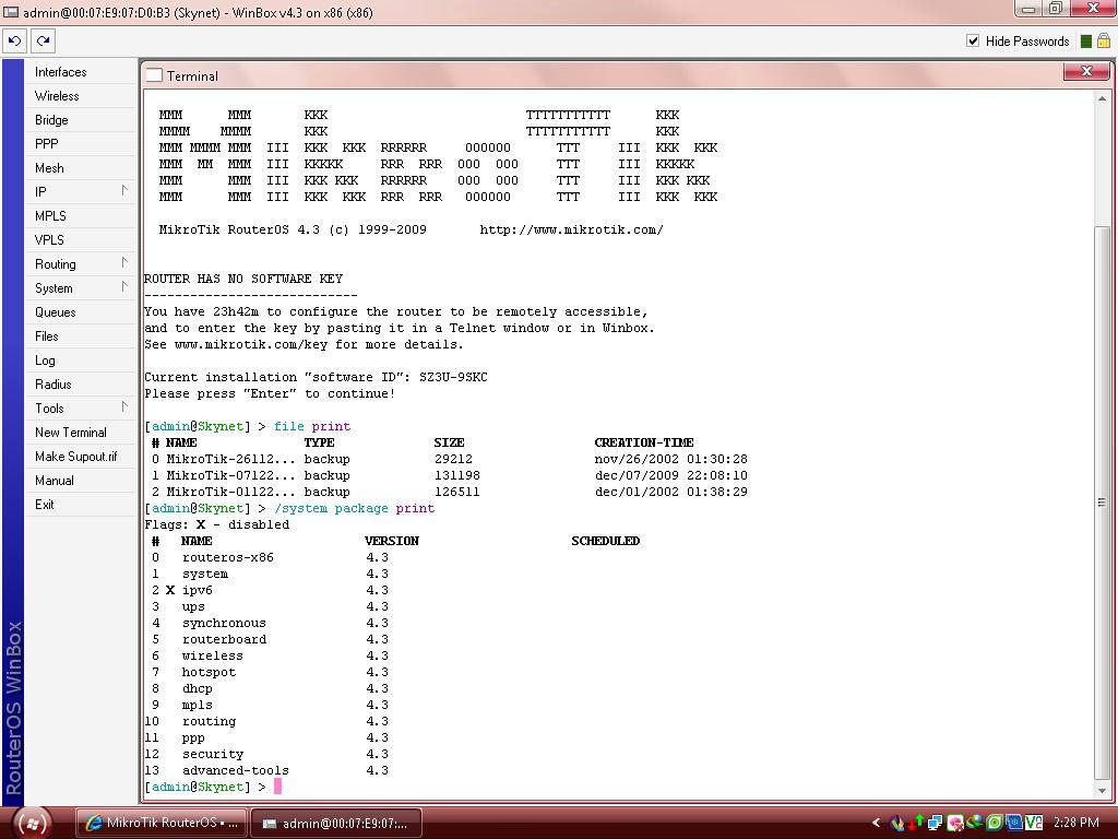

Now, After Upgrade, i clicked on Update License key but its says INVALID REQUEST RECIEVED and its now for 24 Hours trial Period.
Please guide me with the proepr suggestion.
Thanks.
Why are you connected over MAC address? Connect via IP address and then click “Update key” in Winbox License menu. Never connect with MAC unless there is an emergency!
Same Error.
Please Help Me To Solve This Issue.
You don’t have a valid license on the device. Did you pay for your license ? Please contact support with the SoftID that you paid for, and we will figure it out.
