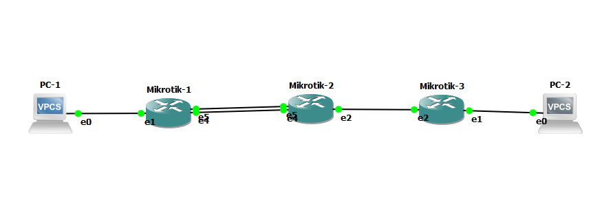

I followed wiki, https://wiki.mikrotik.com/wiki/Manual:Bonding_Examples, with some modifications:
  • when defining eoip tunnels at “many end”, also specified src-address
  • added specific routing tables for each tunnel at “many end”
  • added specific routing rules for each tunnel at “many end” (instead of marking)

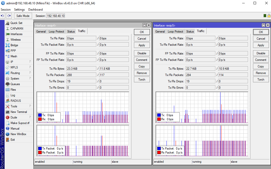

    Test design in GNS3:
when pinging from client at one end to other end, over bonded tunnel, observed following use of the eoip tunnels → so each eoip tunnel is used round-robin, as intended
Config M1:

this is not what I wnat to do
I want M1 to go out with 3 address\interfaces
and M2 to have only 1 address\interface
so I want to go from M1 to M3 …
Thanks ,
This was a proof of concept, just to demonstrate that it CAN be done and HOW it could be done. You’re welcome!
What do you mean by “I want M1 to go out with 3 address\interfaces”?
“so I want to go from M1 to M3”
M2 is there to “simulate” internet / cloud / any other routers in between. It doesn’t matter from configuration point of view for M1 & M3
