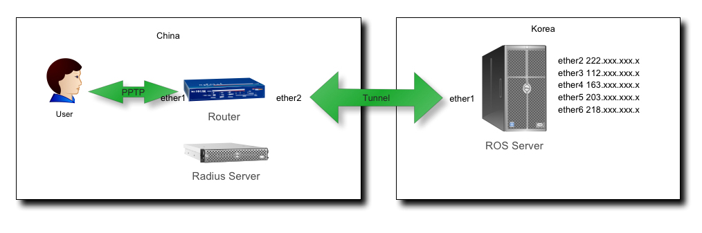

hope this will help :sunglasses:
xone87@yahoo.com
Thanks for reply X187.
Yes your diagram show what exactly i want to do.
But i’m still need to decide which tunneling protocol to using between China-Korea.
after then need to setup static routing from China Router to Kores Router.
Jin Lee.
P.S. Which application using to make diagram? Visio? Concepdraw?
cool project :slight_smile: i’m using visio

I want setup 2 kind service.
For Normal Clients,(Maximum 1000 Client)
  1. Make tunneling between ether2@Server1 and ether1@server3 Using IPB3@server1
  2. Normal Clients group in China PPTP connect to ethr1@Server3
  3. Radius1 handle authentication for Normal China Client Group
  4. All Clients get Private IP from Server3
  5. All client PPTP Traffic forward to Tunnel
  6. Server1 load balancing ether2~ether6 connection with PCC. And forward back to tunnel.
For VIPClients (Maximum 250 client)
  1. Make tunneling between ether1@Server2 and ether2@server4 Using IPB3@Server2
  2. VIP Clients group in China PPTP connect to ether1@Server4
  3. Radius2 handle authentication for VIP China Client Group
  4. All Clients get Public IP from Server4 using IPB4
  6. Server2 connect to ether2 connection IPB4. And forward back to tunnel.
