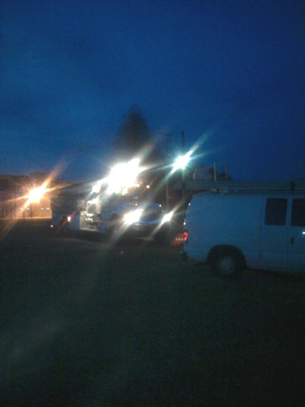

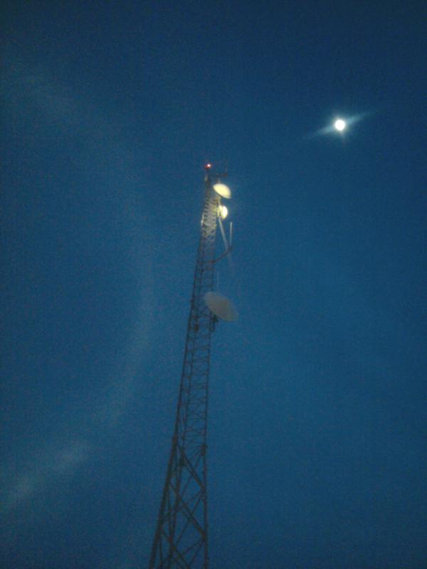

BTW, here’s a couple of (crappy cell phone) pics from that climb… it started getting dark, so we had one of the guys from the VFD pull a rig out and light the tower up for us.
