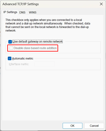

Unfortunately it looks, that your router doesn't push routes to your VPN clients. The route 192.168.255.0/24 is automatically set by windows, because it is base on IP class (Class C) of VPN. BTW, it is possible to disable it:

5nik is of course correct. Apparently I had set up some combination of Windows-specific VPN-specific routes, and static routes, and forgotten ...
Thank you for the note about disabling Windows VPN client class-based route addition. That really shouldn't be a default....!
