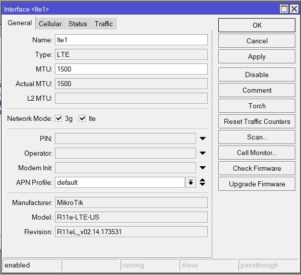

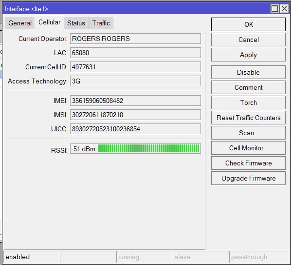

Hi there,
My Canadian Rogers sim card can support both LTE and 3G bands but unfortunately, I can not connect to LTE with my wAP LTE-kit US.
Even though, I can connect to 3G without any problem.
Does wAP LTE-kit US can work with Canadian LTE operators such as Rogers?
Also, there is not any band selector on my interface page! Why?
Anybody can help me?
How can I switch the LTE bands on this wAP?
Finally, I could find the resolve for Rogers LTE
We should run these commands to identify APN for Rogers.
/interface lte apn
add apn=ltemobile.apn name=Rogers
