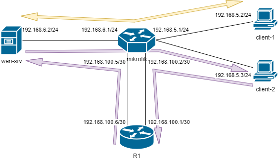

I am trying to implement the following scheme:
The traffic from client-1 (192.168.5.2) to the server wan-srv (192.168.6.2) should go directly through the MikroTik and then to the server wan-srv.
The outgoing traffic from client-2 (192.168.5.3) to the server wan-srv (192.168.6.2) on the MikroTik should first be routed through router R1, then return from it back to the MikroTik, and then go to the server. Incoming traffic should return to client-2 directly, without routing to R1.
Server is unaware of the 192.168.5.0/24 network, so NAT needs to be configured on the MikroTik interface facing the server.
The traffic from client-1 is successfully NATed, and the connection is established, but the traffic from client-2 reaches the server with the original IP address because, for some reason, the NAT rule does not work.

Maybe this needs to be implemented differently? Could you please advise?

The reason why it does not work is that the first pass of the packet from client 2 to wan-srv (client 2 → R1) uses the same IP addresses and ports like the second one (R1->wan-srv), so the RouterOS firewall handles them using the same tracked connection. So the initial packet of that connection (from the perspective of the firewall) leaves through ether4 and therefore the action=masquerade (or action=src-nat) rule does not match; once the same packet comes in via ether5, the firewall treats it as another (non-initial) packet of an existing connection so it does not even use the nat table (only the initial packet of each connection passes through nat, all the subsequent ones are handled up to the nat decisions made for the initial packet that are stored in the context of the connection). The fact that a distinct routing table is used to handle the first and second pass is irrelevant.
So I would say that the easiest way out is to add the following rule:
/ip firewall raw
add chain=prerouting in-interface=ether3 src-address=192.168.5.3 action=notrack
It will let the first pass of the client 2 to wan-srv packet bypass the connection tracking module, so the latter will treat the second pass as the initial packet of the connection and consult the nat table when processing it.

Thank you very much!
This should have been obvious to me, but I mistakenly thought that the interface was also considered in the conntrack table. Although it is not.
Now everything works.
