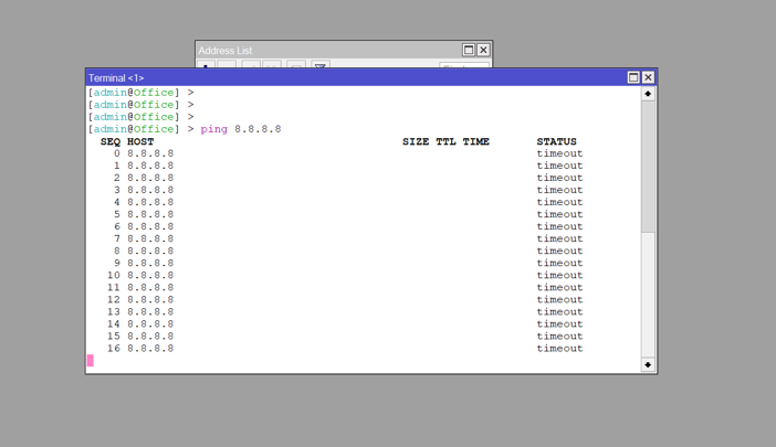

can not ping 8.8.8.8 from my MT router

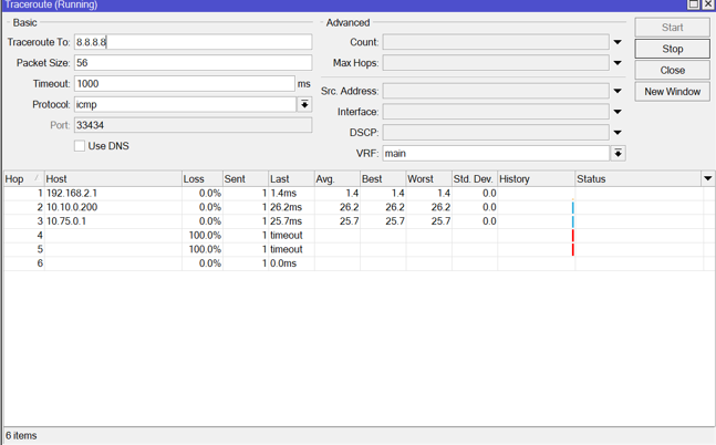

Hello my friends ..! so i just realied that i can’t ping 8.8.8.8 from my mikrotik and when i traceroute the ping i get this
the 10.10.0.200 is not my public ip.
but when i ping 1.1.1.1 i get response and my public ip as the first ip in the list.
so anyone have any idea on what may be cause this..?

192.168.2.1 is your modem, I guess. And 10.10.0.200 maybe a port forward or something in your modem…
Experienced the exact same today.
From client can ping 8.8.8.8, but NOT from Mikrotik itself
[admin@MikroTik] > ping 8.8.8.8
  SEQ HOST                                     SIZE TTL TIME       STATUS
    0 8.8.8.8                                                      timeout
    1 8.8.8.8                                                      timeout
    2 8.8.8.8                                                      timeout
    3 8.8.8.8                                                      timeout
    sent=4 received=0 packet-loss=100%

When you encounter such a problem do traceroute 8.8.8.8.8 and you will find out on which device the problem occurs
