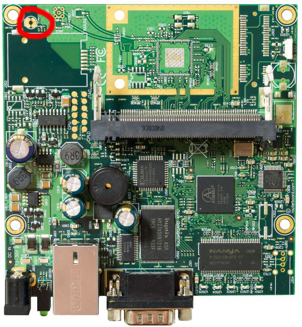

First of all reset your routerboard with short this island whit a screwdriver while you’re router board supplies see picture

Hi, i have tried to reset like that 100 times. when i give power i hear the first beep and the lights go on. i do not hear the second beep.
