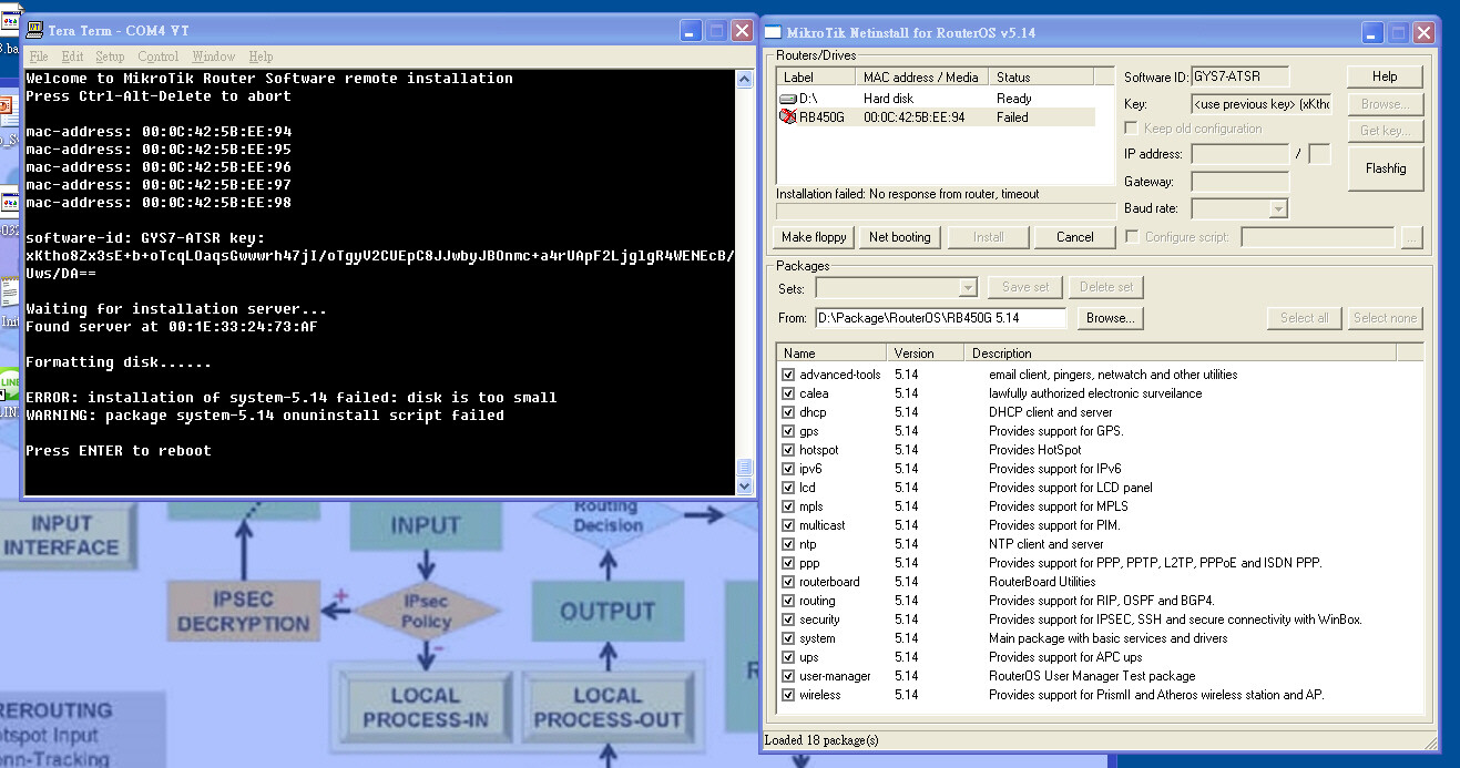

Recently, I use netinstall to upgraded RouterOS from 4.17 to 5.14.
Most of them are working properly as usual, but one is crashed.
I always got an error messge “disk is too small” in the installation stage.

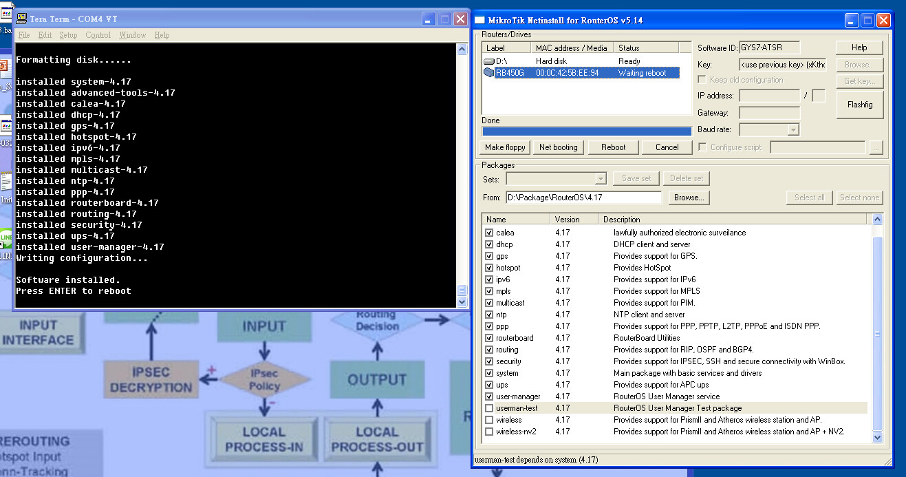

After many times fail, I gave up, through netinstall, I can reinstall this RB450G
downgrade to 4.17. It works properly with 4.17 once again.

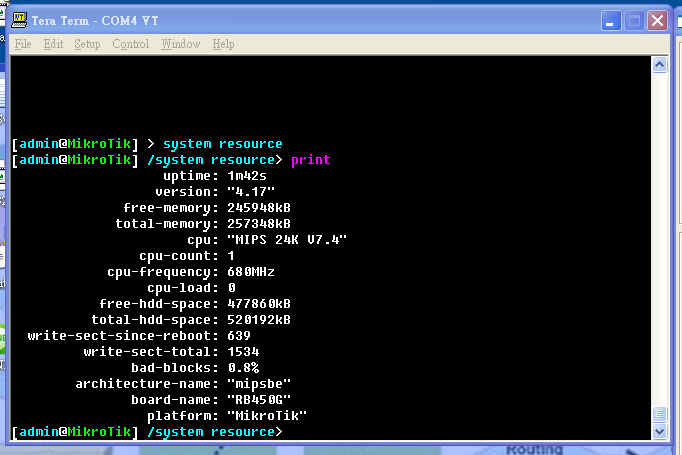

I check the free space = 477.8MB, bad block=8 and license upgradable to v6.x.

ps. both firmware 2.29 and 2.39 got the same error

what you see in
 /system resources

can you install 5.14 on the board using netinstall?
Yes, after upgrade 5.14 fail, I use netinstall to install 4.17, it is OK.
I did use netinstall to install 5.14, but it’s always show ERROR: installation of system-5.14 failed: disk is too small.

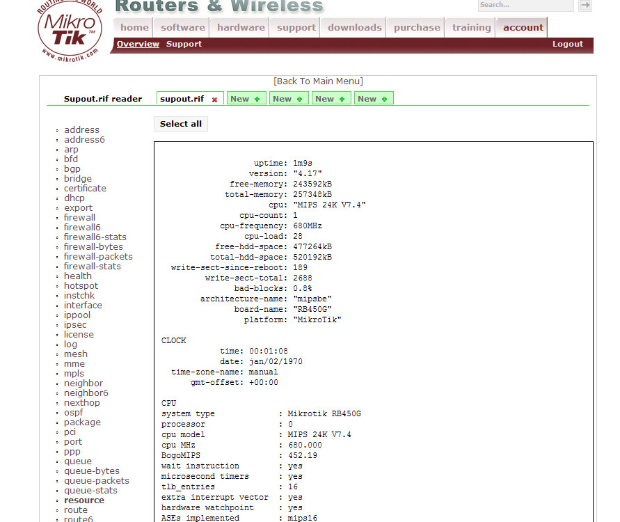

Do a supout.rif and send it to Mikrotik.

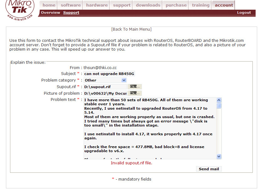

I tried to send supout.rif to Mikrotik support, but always got the message “Invalid supout.rif file.”
But the same supout.rif file can be uploaded by Mikrotik supout.rif reader page and looked normally.
Send it via support@mikrotik.com
Done. If get any progress, I will report here.
