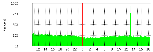

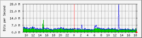

Running ROS 3.24 on RB1000 in a data center setting, routing traffic to/from client VLANs via a network of L2 switches. I have a couple of clients in my network who occasionally seem to create or receive little “packet storms”: brief bursts of traffic that are moderate in terms of Mbps but enormous in terms of the PPS increase through the router. For instance, one of the clients today had a brief burst that registered under 30Mbps data rate, but pushed the router’s PPS from it’s typical 10K to nearly 100K, and as you can imagine it put quite a load on the CPU as well. This particular router is typically moving 50-100Mbps in both directions and registers a PPS of about 8K to maybe 12K to do it, so I can only surmise that these burst represent a brief “storm” of very small packets that really tax my router. Here’s the graphs of his traffic, PPS on the router, and CPU on the router:
Unfortunately, when I contact the client to ask if he has any idea what it was all about, he just shrugs. The other one is of the type where I would not even waste my breath asking. So as a mitigating measure, is there something I can do to tell the router to just drop/ignore any packets that are less then a specified size? Failing that, how about limting the maximum packet rate in some way? The last time this happened with this client, it taxed the router severely enough that I experience bad latency throughout my network and clients complained…

The traffic spike which corresponds to the CPU and PPS spikes shows up only on the one client’s interface (which is a VLAN, by the way) - they are very clearly related. I do have a queue set up for that client, and interestingly, it’s set to 20Mbps max limit up and down, yet the peak on his interface got closer to 28Mbps. I’m not sure how that’s possible but in any case, the evidence indicates that the cpu and pps spike was due to traffic on his VLAN.
