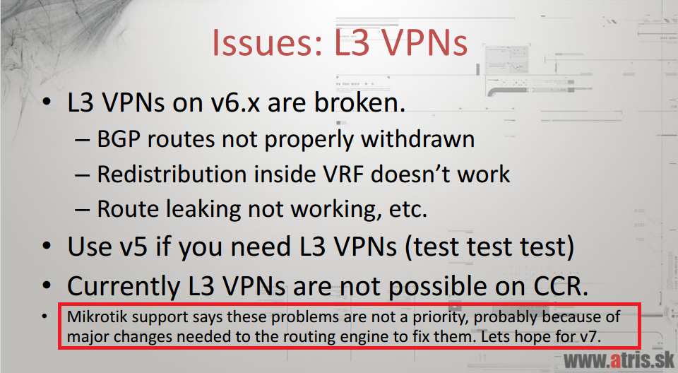

From presentation,Tomas sad:
Thanks, nichky. When it was presented? Last mum in Milan?
UPD: This is old slide from 2013, that is not fully correct anymore.
L3VPN works fine within one AS
That slide is semi-accurate.
L3VPN became usable with 6.2, e.g. Mikrotik fixed the L3VPN withdrawl bug. As for Route Leaking, it has always worked for us, Maybe Tomas was doing something different from us…
However there are still some major bugs in RouterOS v6 routing. e.g. BGP NLRI’s are not sent when a route received via PE-CE BGP becomes active over a L3VPN received route.
These will not be fixed until we see “new routing” which will only appear in the next major RouterOS version, which unfortunately has no ETA :frowning:
