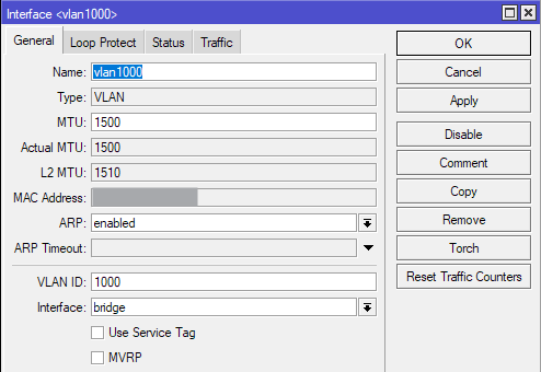

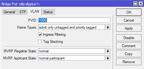

  • An alternative is to keep sfp-sfpplus1 in the bridge, and even put ether1 in the bridge too, so that all ports are in the single bridge. This suits the way the ports and switch chip are wired on the RB5009 very well. because all ports are connected to the switch chip that has full hardware offload for VLAN filtering. You then configure Bridge VLAN Filtering on the bridge, and make sfp-sfpplus1 the access port of one VLAN for example VLAN 1000 (by setting pvid=1000 and set frame-types=admit-only-untagged-and-priority-tagged). Create a VLAN interface with this ID 1000 under /interface vlan. And you can use this VLAN interface as your WAN interface instead of sfp-sfpplus1. This is the configuration I am using on my RB5009:
    Examples
