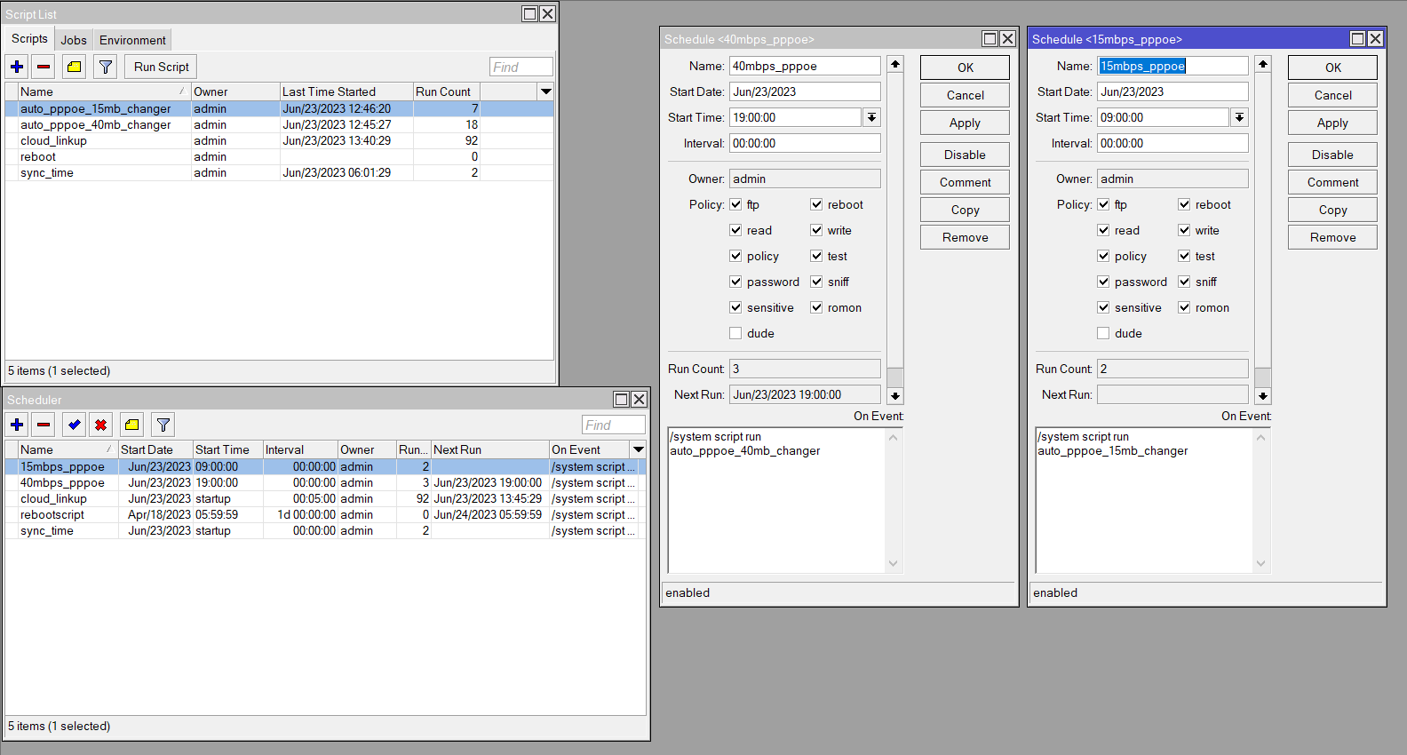

the main reason is that i need to make a script, where it will automatically change the username and password of that pppoe interface and then put it on a schedule.. already opened a topic yesterday for that, but didn’t get any reply from anyone.. So, decided to make a script by myself , but for that trying to get the cli command…
Fortunately i managed the command and made the script, where it will first delete the pppoe and then make a new one.. But because of deleting and creating new pppoe-out service, it will also changing some of my mangle rules.. And now the result is ZERO :frowning:

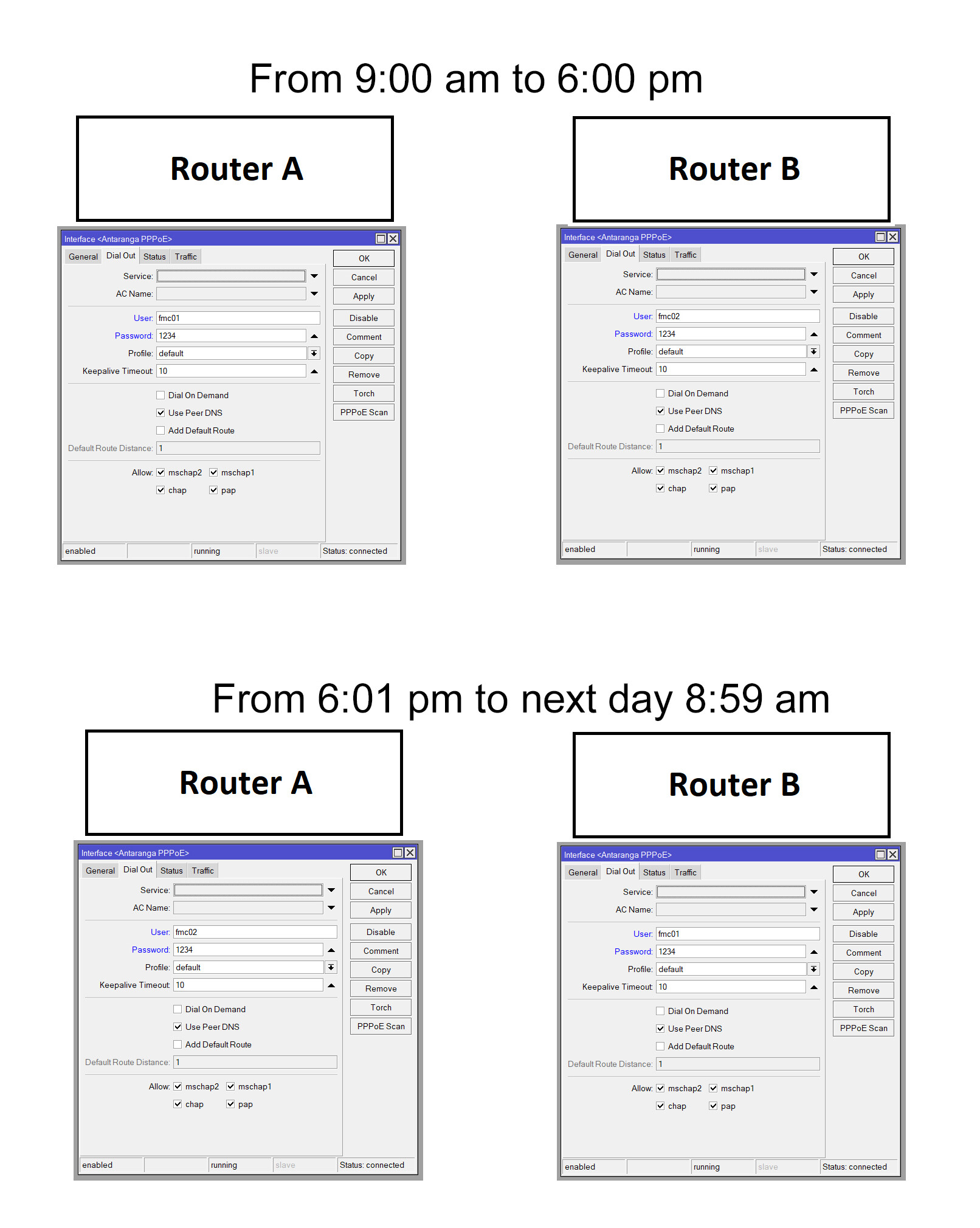

What i need now to put the command line to just change the username and password of that specific pppoe-out interface… More understanding will be found from the attachment below…

an another question, do i need to give any interval, or the schedule is okay.. i want to run these two schedules (15mb and 40mb) everyday.. 15mb schedule at 9am and 40mb schedule at 7pm
Set interval to 1 day (i.e. interval=1d) … so that scheduler runs script at time specified and then repeated every . The same way you have it for “rebootscript”
