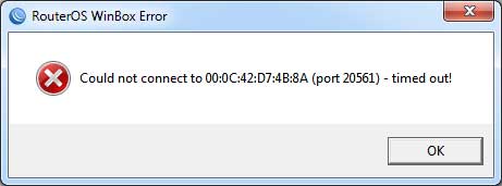

SXTs arrived this morning. I followed the walkthrough that you referred me to and everything went well on part 1, but when I created the bridge in part 2 you couldn’t winbox to either device?
Any advice you could offer would be great!

Do you mean you can’t connect to the remote SXT?
Did you add ether1 and wlan1 to bridge port?
Do the configuration step by step. It should have no problem.
Yes, followed it step by step and as soon as I add ether and wlan ports to both SXTs they stop responding?

try to connect via IP instead of mac address. I think you are using Win 7 or Vista and the firewall is not turned off.
For connecting to RB via mac address the firewall should turn off or has an exception for port 20561
If it was a firewall issue wouldn’t that mean I wouldn’t have been able to connect in the first place?
No, I mean the winbox use port 20561 for connecting to RB via MAC. If firewall is on etc …
Are able to ping your remote SXT through local STX ? or can you log on to local SXT? If yes, go to tools ping and try to ping the remote SXT!
just another thing, did you use SXT default configuration or remove it at the first start up time?
