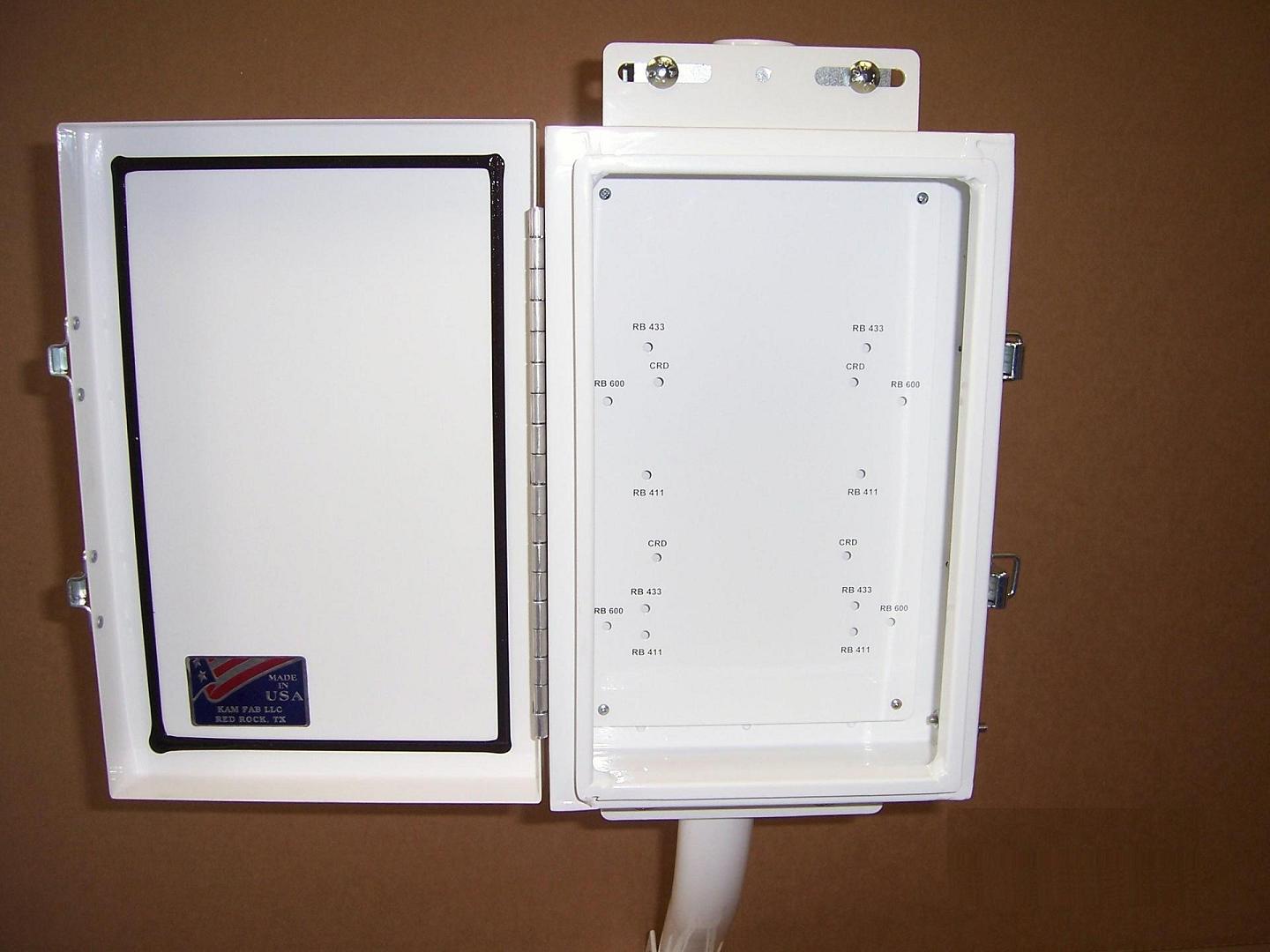

The problem is that you put your RB800 in a closed box and think it’ll work flawlessly under extreme conditions.
Well where does MikroTik expect you to put it, outside strapped to your tower without an enclosure? And why does the RB600 work flawlessly, even wth an overclocked CPU, in the same enclosure with the same wireless cards?
Also, since when is 21 degrees ambient “extreme conditions”?
Inside the enclosure. :slight_smile:
What do you have for enclosure?
Ut7 box same as for the rb600
Personally my units are closed, but if this was a problem, surely it wouldn’t have been created in the first place?
If you down-clock it to RB600 frequency it’ll produce same amount of heat and should work in whatever box RB600 worked. Higher freq will require enclosures that dissipate heat at greater rate - large surface area (ribbed) and aluminum- or fan cooled case.
Exactly!
http://www.wirelessenclosures.com
