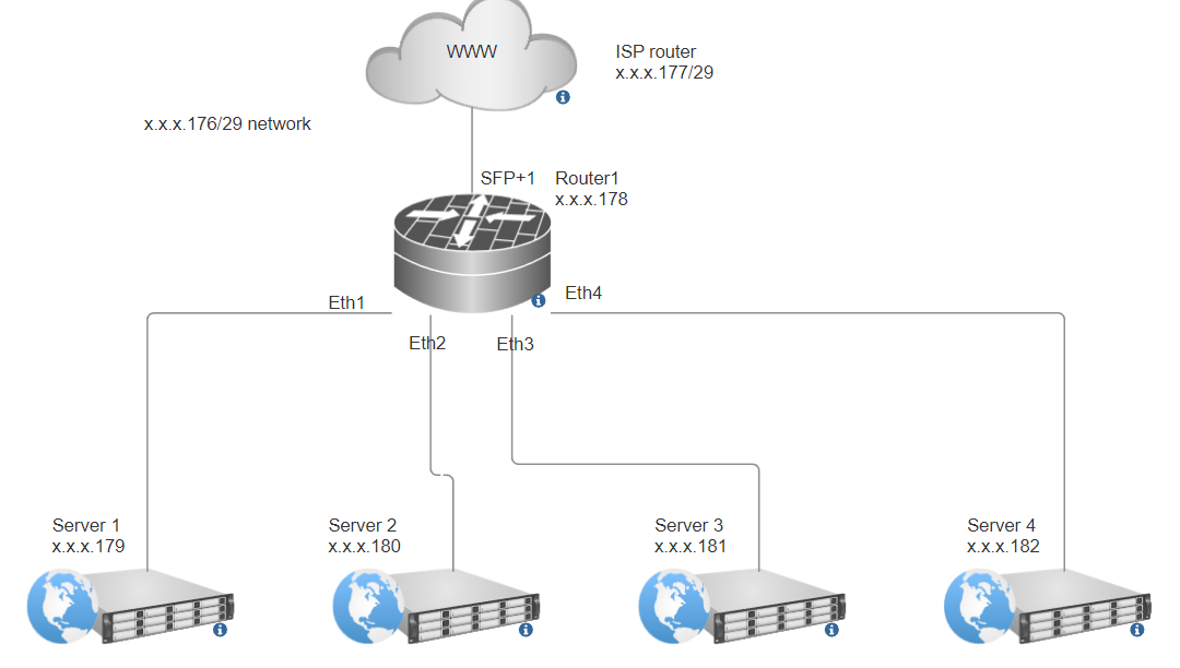

Looking to see a fully working config for a /29 network. Maybe even different examples if you have them. Rough network diagram attached.

your diagram/networks It’s fine as it is but really depends on what you are doing and trying to achieve, but i will do it differently because public ip is very scarce i will conserve it if i have to as much as possible, if some servers or workstation can be behind a NAT i’ll do it.
You can create a new bridge and put Ether1-Ether4 in it. Assign x.x.x.178/29 as /ip/address the new bridge, and the desired static assign on servers. Assuming you have the default firewall/config, you need to add the new bridge interface to the “WAN” interface list (under Interfaces > Lists) to protect the router.
Same approach is possible using VLAN as the WAN, instead of new bridge. You need to be using vlan-filtering=yes in bridge, assign x.x.x.178/29 to a new VLAN, and tag ether1 to ether4 with the new VLAN ID. This be useful if you servers need both the WAN and LAN (assuming servers are VLAN-aware).
@loloski advice isn’t bad and some way also safer (since you’d defining the ports needed). Basically, approach is you essentially assign all the IPs the router and use either action=dst-nat for ports, or even action=netmap to map all ports to specific host in /ip/firewall/nat (e.g. NAT defines the mappings, including which of the public IPs to map it to). The servers only see there LAN address in this case & all access is gated through the Mikrotik router.
In all cases you’d need an /ip/route for 0.0.0.0/0 to x.x.x.177.
I have a CCR2004, it came without a config. I want this monolithic ip per server setup to support FTP server. If I’m doing the simple setup as mentioned in the first paragraph, what do I do with the sfp+1 interface? If .178 is assigned to the bridge, can it also exist on the sfp+1 port?
Right now I have
add interface=bridge1 list=WAN
add address=x.x.x.178/29 interface=bridge1 network=x.x.x.176
>>> do I add this??: add address=x.x.x.178 interface=sfp-sfpplus1 network=x.x.x.177
add bridge=bridge1 interface=ether2
add bridge=bridge1 interface=ether3
add bridge=bridge1 interface=ether4
>>> do I add this??: add bridge=bridge1 interface=sfp-sfpplus1
No. Leave the address as /29.
But you need a route:
/ip route add gateway=x.x.x.177
If you want to make it a switch for the WAN, then yes:
/interface bridge port add bridge=bridge1 interface=sfp-sfpplus1
