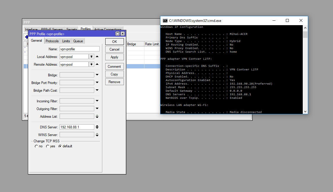

Remove google DNS server from VPN profile
@karlisi, Thank you for responde.
Removed google dns and didn`t work. :frowning:
I attached capture screen.
It’s very hard to guess what is wrong only from video and screens. Can You post output from /export hide-sensitive ?

Try this
/ppp profile
add dns-server=192.168.90.254 local-address=192.168.90.254 name=vpn-profile \
    remote-address=vpn-pool use-encryption=yes

No, it`s not work :frowning:
