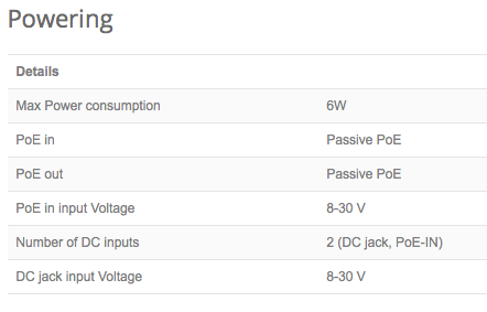

RB2011 PoE Out is Passive only, not af nor at, you can’t use a RB2011 to power the HP.

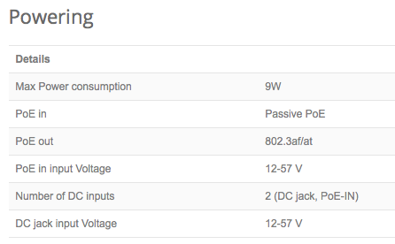

You need to either get an standalone PoE af injector, or use a different Router which supports PoE Out af/at, like an hEX PoE
