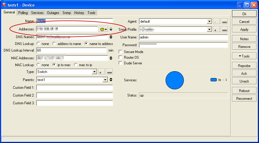

can you please guide me how I can do add the IP addresses and make it work?
Right click on your device in the dude, click the IP address box and type the IP address of the device you want to monitor.
